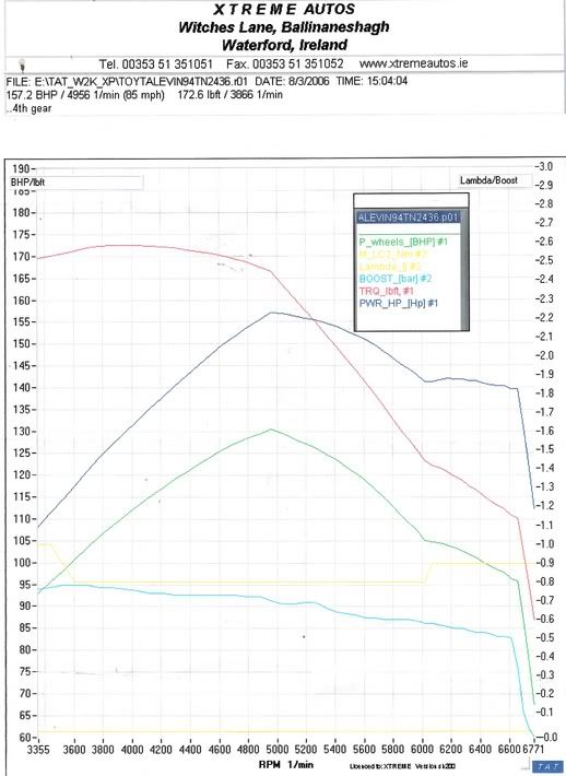

ok so has anybody got any ideas where or how i am loosing all this power.
this dyno graph shows good torque but the wheel hp is at 130 thats at least 40hp down with my mods on that engine.

check your torque, your dyno sheet shows that your engine has a whole 20lb-ft more torque than any stock 4agze.
so here's what i can understand from your lost of power:
you work your supercharger too much, it gain more torque low end, but lost power at higher rpm cuz its just too hot to work effeciently. You should know how hp/torque is calculated, so if your high end looses torque, then you loose hp as well. same thing like diesel engine, high low end torque, but not a high rev engine, thus low hp figure.
basically, your engine already IS more powerful then stock gze (under 5k rpm that is)
so many people forgot about hot air problem in malaysia.
waxer52 ah, tell you something lah.... I remember reading a turbo driving at 240km/h cause the wind to be hot hence lack of oxygen..... in order to overcome this problem they had to use air-cond cooled parallel intercooler.
this is one area for you to check.... I support rollakid's statement.
ok just sorted the boost problem by adjusting the belt properly. holding boost all the way to red line now. can still feel the drop in power at 5500 rpm.
this seems to be the problem with all gze's. anyone got a fix that definately works. some say its the ecu, others say its the knock sensor.....

the only mods i have on my car are 176 mm oversize crank pulley and an exhaust from the manafold back. i will shortly be front mounting the intercooler. hopefully this will bring down the intake temperatures and get rid of the 5500rpm power drop. since the dyno was done i have tightened my supercharger belt and this has stopped the boost dropping off.

waxer,
thats about the limit of the sc12 charger, front mount the i/c might help, but it won't change the characteristic of sc12 being ineffecient after a certain rpm in the blower itself.
using bigger pulley will more or less mean you shift the torque to the lower rpm range.
