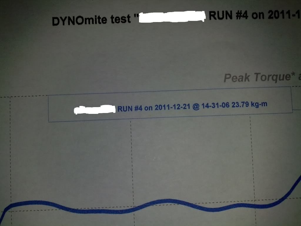

Initially, I was disappointed. But after seeing the comments from you guys here, it made me feel better. I know the money spent did not go to waste.
Mind to tell how many BHP would be considered an achievement for a 2L? When I read back the previous comments, I don't see anyone mentioning about that la? Or I must have missed it between the lines. Just got up. My "ECU" still not registered yet.

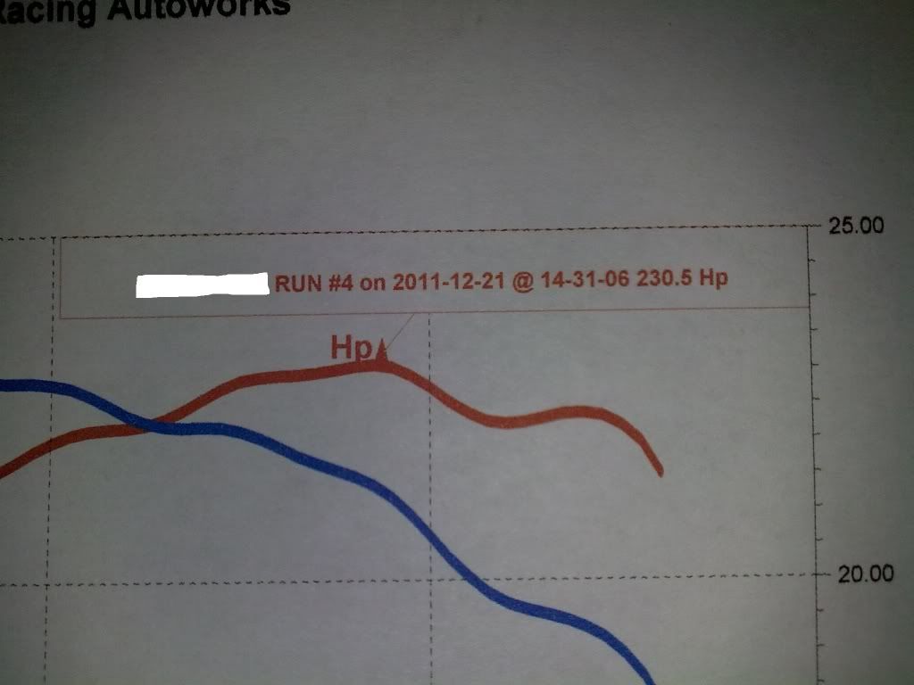

I said 100HP/LITER (of engine displacement), not 100HP as an absolute value! :) So for a 2ltr car then try to get 200HP. How many NA cars on the streets today can reach 100HP/ltr? Still very few only right? Mostly all considered high performance/sports car already, like Honda Type-R, all current Ferraris, Lambos, some Porsches, M Power Bimmers. :) But again max power numbers be it HP/ltr only tells just part of the story, more important is how linear the power is produced cause that determines the way it drives. That's why many car manufacturers still do not make engines reaching 100HP/ltr, the most obvious example is Mercedes, but their cars are still plenty fast and pulls like mad due to the very fat torque from big2 engines.

Ok, first, hp is torque x rpm. Basically, more torque means more power. But since engine doesn't operate at one rpm and instead over a range of rpm, you get different torque at different levels. But basically, at any rpm, the more torque you have, the more hp you will get.
The hp (bhp or whp) figures, it depends on which dyno you go. Dyno Dynamics will net you the lowest figure in terms of figures compared to DynoJet. Dastek Dyno (RS Dynotune) give power in bhp. But the most important think is not which one is accurate or better, just don't try to compare dynos from different dynos.
The figures from dynos are the numbers in WOT, where you slam your accelerator pedal to the max and get the torque and hp curve. Your figures is quite linear really, and can be broken into two parts. Without even you telling others what your car is, one can know its either a MIVEC or a VTEC.

I get it now. My mech told me that if I use a suitable camshaft I should get a more linear torque curve. He also said with a hi cam, the VTEC pull won't be so obvious as compared to now. I remember him saying something like this.
- What your mech says is correct. VTEC gives you the hard pull because there is huge characteristic difference from the different cam profiles. When you change cams, the profiles different between the low and hi cam might not be as obvious, so you don't feel it is pulling as hard but it is really pulling harder. Imagine this, if you sit on a friend's car driving at constant 140 km/hr, you don't feel fast. But if your friend drive at 60 km/hr, then suddenly like mad cow slam the pedal and drive to 120 km/hr, you feel it is pulling hard and fast.
