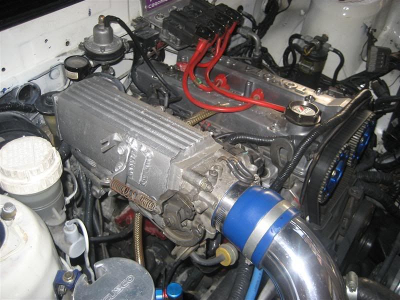

I've been calling 4 ppl for the same cam pulley, this fellow then follow the next one and the next one and the next one but the last fellow told me that the Toda adjustable cam pulley still in his customer car. damn!!!
I already check out the Redline motorsport adjustable cam pulley for 4AGE. The outlook is great and according to the boss that is the new design which utilised T6 alluminum.
I forget to ask whether it's 6061-T6 or 7075-T6 material.
I'm still hoping to get Toda adjustable cam pulley because the material is 7075-T6 with is the greatest among all alluminum material. But it doesn't look as fancy redline pulley.

sham..when to migrate to 7ag pulak? chu..setupid question..r u running with stock cam pulley? btw really great project u got there..
yes, stock cam pulley now, torque is much better then 4AGE but HP is not so good now because cam degree setting is out of spec alot.
me also at first going for 7ag had problem with the cam timing bcos of what u said earlier, the cam advanced about 5 degree..after running with adjustable cam pulley (custom only :bawling:) the power increase significant..although running 0-0 (stock) cam degree.cant wait to see the result of your fine tuning..good luck chu :burnout:
yes yes, mine also advance by 5 degree both side. beside that I'm also using 0.5mm metal headgasket which mean it's already advanced more the 5 degree each side.
Initially just want to dial back to stock cam degree.
