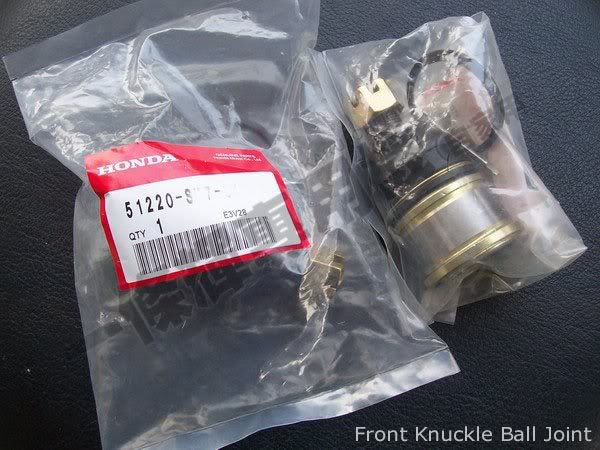

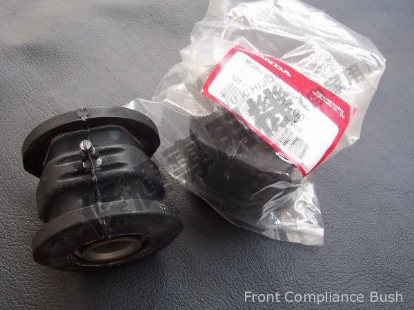

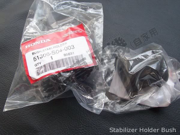

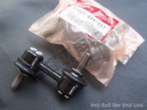

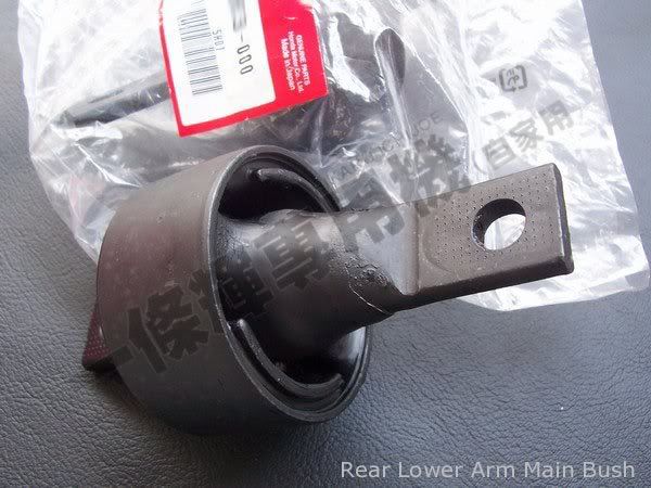

You definitely have to replace for front and rear:
a. Upper control arm (Front & Rear)
b. lower control arm (Front & Rear)
These are the other main things that you need to change as well
1. Antirollbar link (front & rear)
2. Front compliance bushes
3. Front knuckle ball joints
4. Rear Lower arm main bushes
5. Stabilizer holder bushes
Go and buy these parts at any reputable honda stockists, then have them installed at your prefer workshop that you trust.
Or go to HSC.
Always insist those original Japan parts if you plan to keep the car for long, but stand by 2 grands for them.
