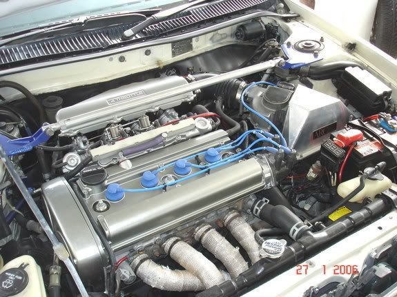

y u take out tat arc filter... not good ?
hihi.. very very nice n clean engine bay,...
how was tat arc filter performance and sound.. hihi..
very nice la..
not no good just my mechanic told me would it be quiet hot cos alloy do absorb heat and dissipate heat too, but need to do the partition lor, that's why i replace with the stock filter. Anyway just normal drive marr...
It is consider as inbox filter too. the sound nice but not loud, only when idelling u can hearing the sound like " suuii.........iuuu......." in the arc box, the internal design also got one trumpet like that. But sure when night time rev, u can clearly hear the sound " Yiiii.....iii.....yyyiiii......." that the sound of inhale from ARC.
