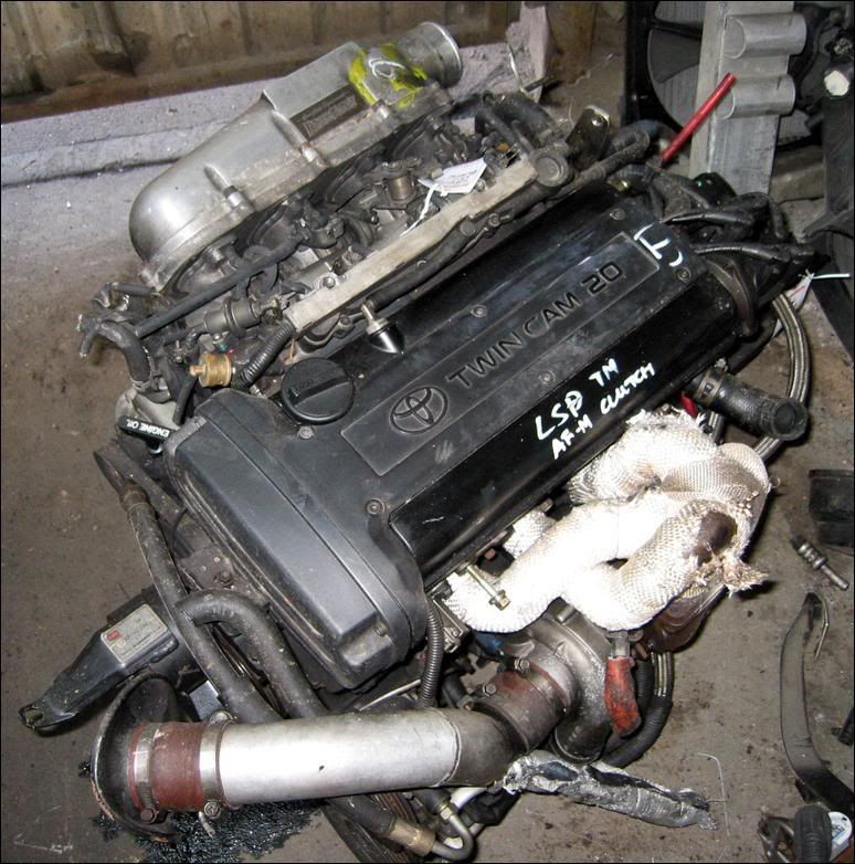

Easiest and cheapest way is to turbo your BT. Can easily hit 200bhp without breaking your bank account. Its cheaper than NA modding. However, need to change to low comp piston, thicker head gasket and custom header. Also need e-manage for tuning.
Bro, thicker head gasket, which type and where to get it wor? and low comp. piston, 4AGZE piston can?? hehe
Last time, I seen one 4A-GE 20V BT + big Axx Turbo with 25+ psi boost powered with 4A-GZE piston (Black head), king bearing, thicker head gasket, external wastegate, BOV, intercooler, oil cooler, custom turbo header, adjustable cam pulley, high cam??, Bosch ignition coil, cooler spark plug, bigger injector and halftech management system. Almost forgot, It is a single throttle setup and with VVT disable. The AE86 is belong to one ext 4AG tuner in KK. vh-101, you can call Ah Lun from Bengkel Kolopis on turbocharge 4AG stuffs.
Wah 25psi ..geng.. Bro, Bengkel Kolopis at where o? Yeah, i saw few 20v turbo's pics also single throttle only. why ar? any sifus know why can't use the 4 throttle as intake?
hear many said tat if use 4 throttle for the turbo setup is very dam susah...maybe is the throttle make the air flow tak chun kot....dun know lah ...i also wonder why ah???
i remember my pc got two pic is 4age20v turbo ...but from pic we can see they also use bak the 4 throttle...make me lagi nak tau y one throttle after i saw tis pic...
Wah nice .. haha this half cut original from japan right? So lucky if can find it..haha Hemm i also dont know why some keep the 4 throttle, some throw the 4 throttle.. if 20v turbo, the ECU can use piggyback? or need standalone?
piggybak i think can also but if wan better performance i think standalone lor..pls correct me if i am wrong,,thx
