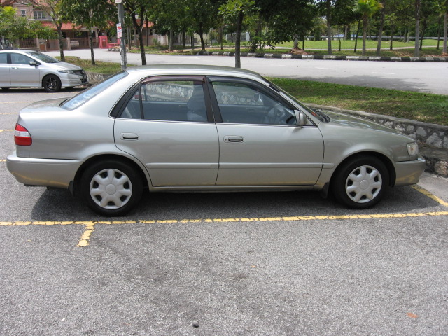

Here is a pic of my old ride. Owned this car for 8 years.
