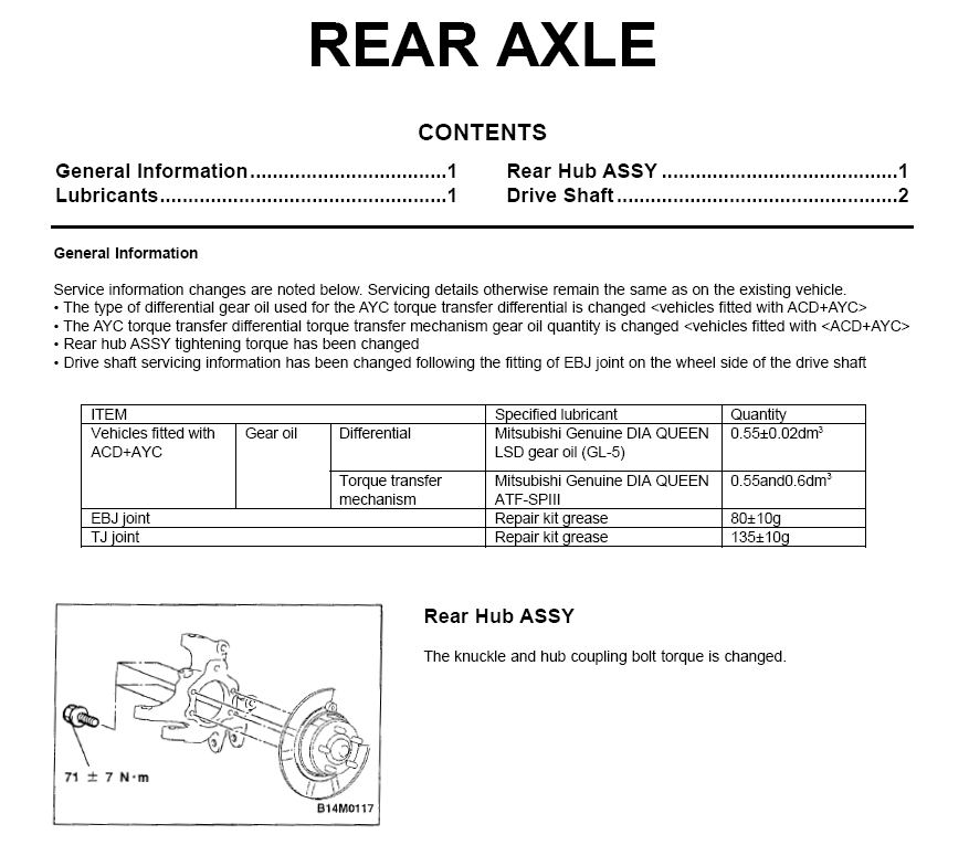

Hi guys,
Hope this might help us as a guideline to choose correct viscosity.
