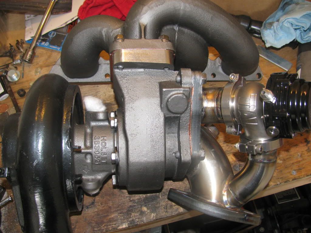

2nd thing, I saw some TC cars owner would install a wastegate to the exhaust manifold even they are running stock boost. is it consider necessary?? plus I some shop people that install wastegate is really not thinking....as for a wategate to perform precisely the positioning & angle of the wategate placement is important. I see most the just drill a hole on top of the exhaust manifold and weld a piece of pipe and connect the wastegate....It looks really shabby and the flow is not precise also as the wastegate is sitting almost 90 degrees on top of the exhaust manifold. I read from TS site that is better to position the wastegate 45 degrees with the exhaust gas flow path...etc.

u're right on the reading. Best position is stock position. Y from the exhaust manifold to turbo n wastegate. However it's not easy to achieve.
Malaysian style mod, ppl like to show what they have in the engine bay. Yeng!!! So the put it on top. If u look at HKS cast iron manifold, they have the wastegate under the manifold instead.
Most of the turbo with internal wastegate will have a hole to the flap in the turbine housing. U can remove the flap and bore up the hole to the wastegate size. On the flangenof the customize downpipe, separate the turbine outlet and wastegate hole, then u can direct the hole to the wastegate.
