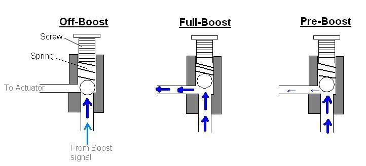

As I mentioned before, one has to understand how a Manual Boost Controller works.
Heres a diagram I made of the "block" type MBC. (the other type would be the "bleed" type)
As you can see, the amount of boost before the actuator yields is regulated by adjusting the screw.
The more the screw is tightened, the higher the boost pressure.
It works by applying more tension onto the spring and hence, more boost pressure is needed to "push the ball up".
Unlike the solenoid valve nor a stepping motor of an Electronic Boost Controller, such "block" type MBC does not, as some of you say, "open upon a preset boost pressure".
Even the responsiveness of an EBC is manually dialled in through more or less Gain.
Therefore needless to say, Block or Gated type MBC also "open" slight (well maybe opens slighty less then a bleed type) as boost pressure builds, the spring is pushed little by little until it opens fully. Whilst the spring is moving up wards, the boost pressure is already signalling the acutator to open slightly to bypass exhaust gases.
Therefore I still feel, adding a MBC does not in a MAJOR way, allow one to "improve spool up", neither does it overcome boost creep nor boost spike.
