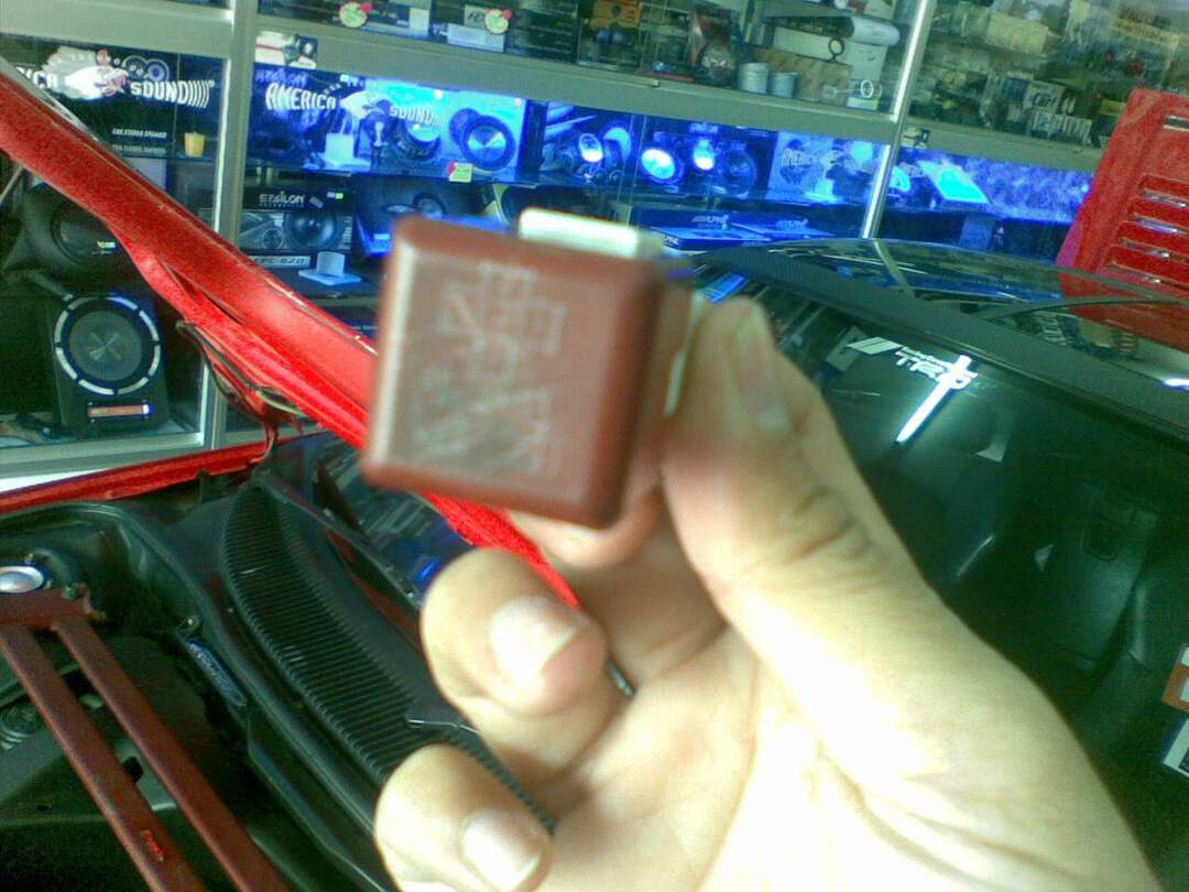

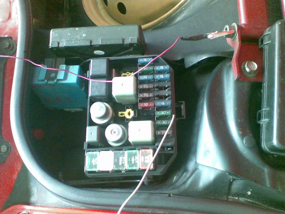

aiite.. dat coolant no oil, that engine oil no water, no sweet smell, no idling issues..i drove last nite and one thing i realize, when i turn off the engine (turbo timer equipped) the two fans running at maximum speed..and i keep an eye of the water temp and it slowly drops including the oil temp..i put 6 minutes and the foam no more and the engine is just fine..but when i turn on the engine, i realize the fan run slower..i decided to check them today and i found out that the fuse isnt working for the right-hand fan.wireman says that da right fan will always on, while the left fan detects heat temperature from the engine.. i dont know how far true this conclusion is but he changed dat fuse..(boxy - look)and the right fan works perfect! now i can hear the fans loudly.. i will test it again ..and hopefully its only that boxy fuse is the cause of that foams.! (heat dissipation)..meanwhile i will source thermostat~ midship, extremeleo and eddy, u are right ;this thermostat will not be invented if it is useless~

hi peeps...yup that fuse is the main problem ~!
thanks for the advise..i drove up to SS2 - klia- putrajaya-home without problems ~
i attached the fuse pixs to share with...note that there is a dark (burnt) surface on top of the brown fuse ...

Superb!! Yet again, the MR2 proves to have simple fixes for a potentially chronic defect..... I think we should have a thread on them la.... chronic defects..... simple fixes..... I've got a few.....
aiiite..drove up to seremban to meet khoo and had a wonderful curry mee and back to kl with no problem..so that relay is the problem :)
