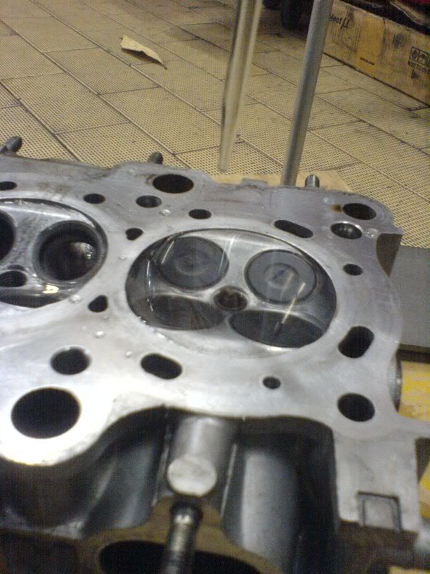

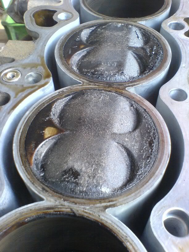

Last I opened the engine, was when I got leaking valves, and the jackets around the sleeves were like super clean. See below, that was just opened, and I didn't clean the sleeves on purpose for this picture, actually this picture was for showing signs of detonation and how it looks like on pistons.
Yes, those are detonation signs, on B16A stock pistons.
Compression test, Skunk2 new valves gives 0.5more, so now I have a
11SCR B16A :P
How many valve grind ppl give you the oppotunity to check leaks? with water some more. (theory is, water molecules bigger, so if it leaks water, it will leak air.)

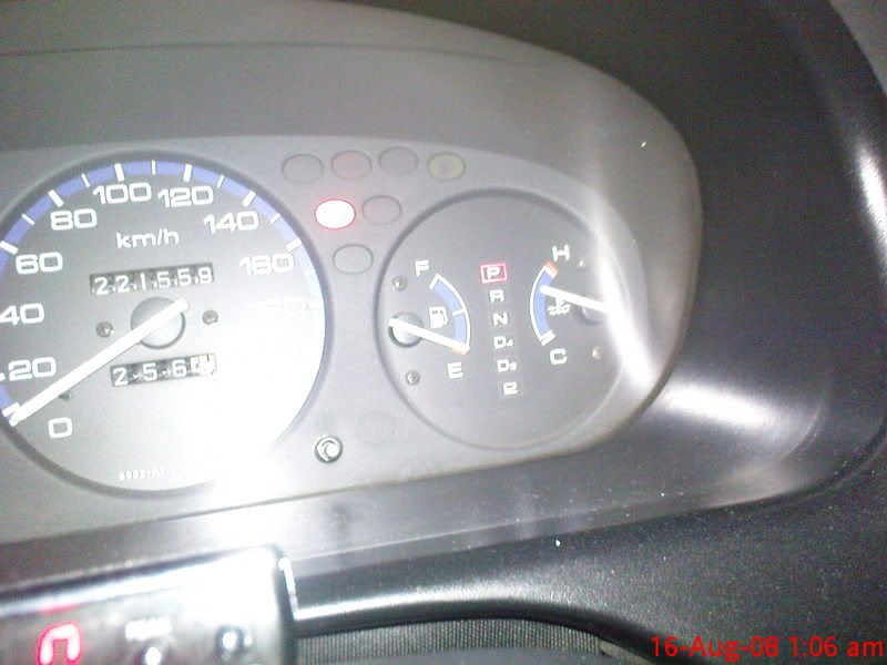

No idea why we have this problem but everything was good before I started filling the rad with coolant. This is what the watertemp on my dashboard looks like after a few laps or long distance cruise :bawling:
The temp will drop gradually once the fan kicks in. I dunno bout you guys but everytime the temp reaches that high its like a nightmare, and when that happens driving isn't pleasent anymore cause I will keep looking at the temp gauge:hmmmm:
Do a radiator flush, or get the radiator changed, perhaps the cooling system is blocked, I think, because in my experience, the stock engine and even an 11.8 comp B20 will never get that hot. Only 12+ comp cars get really hot with all the ignition retard we put in for running with regular fuel.
Of course, maybe your water temp sensor is spoilt also a possibility.
