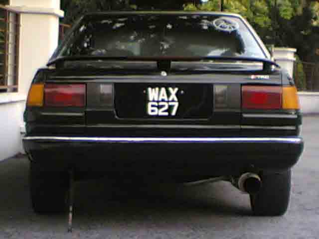

It's illegal to be running around without your number plate lights, bro...
BTW, nice ride :top:
