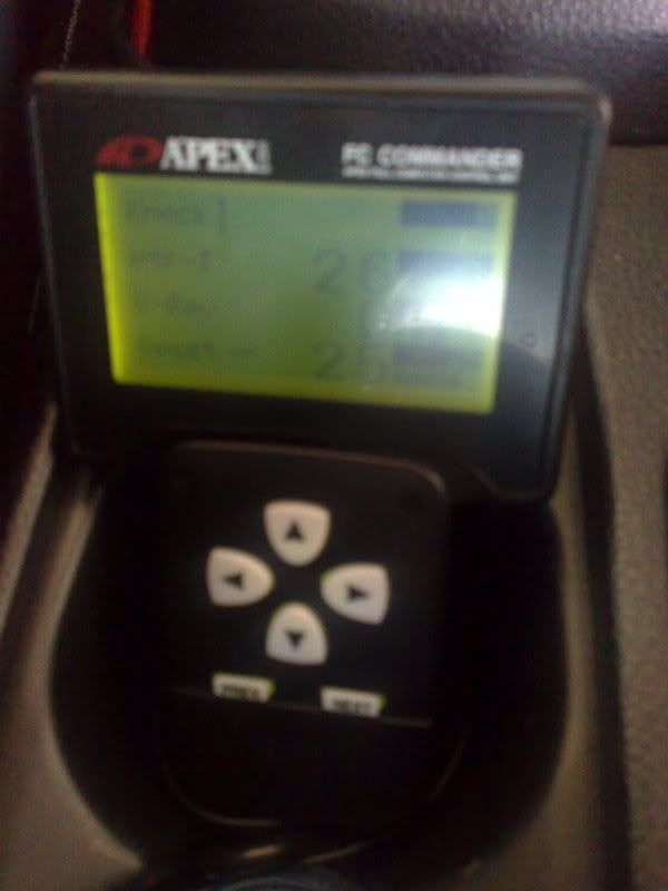

Hehehe...mine also got pop and boom sound sometimes got fire come out from exhaust. but only happen when at high rev and let go the pedal...it happen because i tweak the AF ratio..to supply more fuel at high rev. so everytime after high rev then let go pedal sure will....boom....pop.pop (sometimes plus fire)....:_: very fun though but dont let JPJ or polis spot me....sure kena wan....:confused_smile:

hehee sounds fun .. but arent u afraid of damaging any parts of ur engine or spoil ur muffler...? :regular_smile:

Hehehe....that's why i drop in forged piston set, conrod and other stuffs....my muffler is still very good, use for quite long already. Its a Mazdaspeed muffler. Last time use Tanabe wan but gf complain noisy...hehe
bro, i dont drive with hihg rev everytime lah....how to rev high high at street ....
