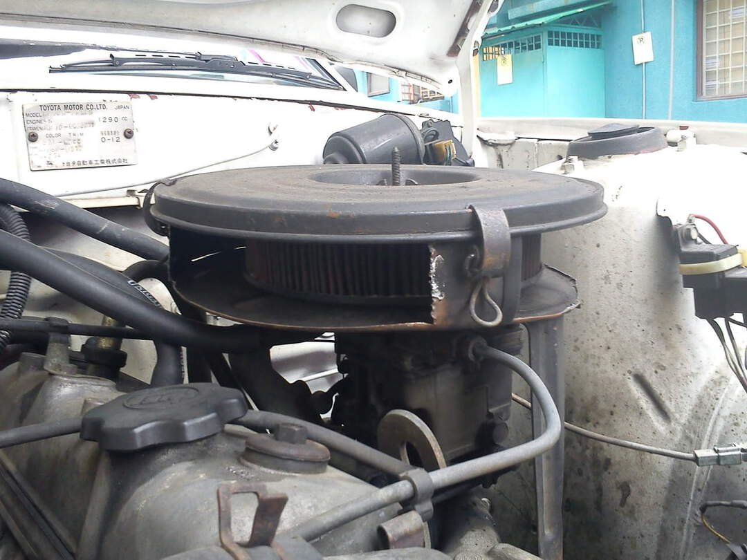

my air filter is not exactly open pod.. i modify it to suck more air than the original intake..
and also i make sure air can come from left & right because this car is meant to go sideways.. :biggrin:

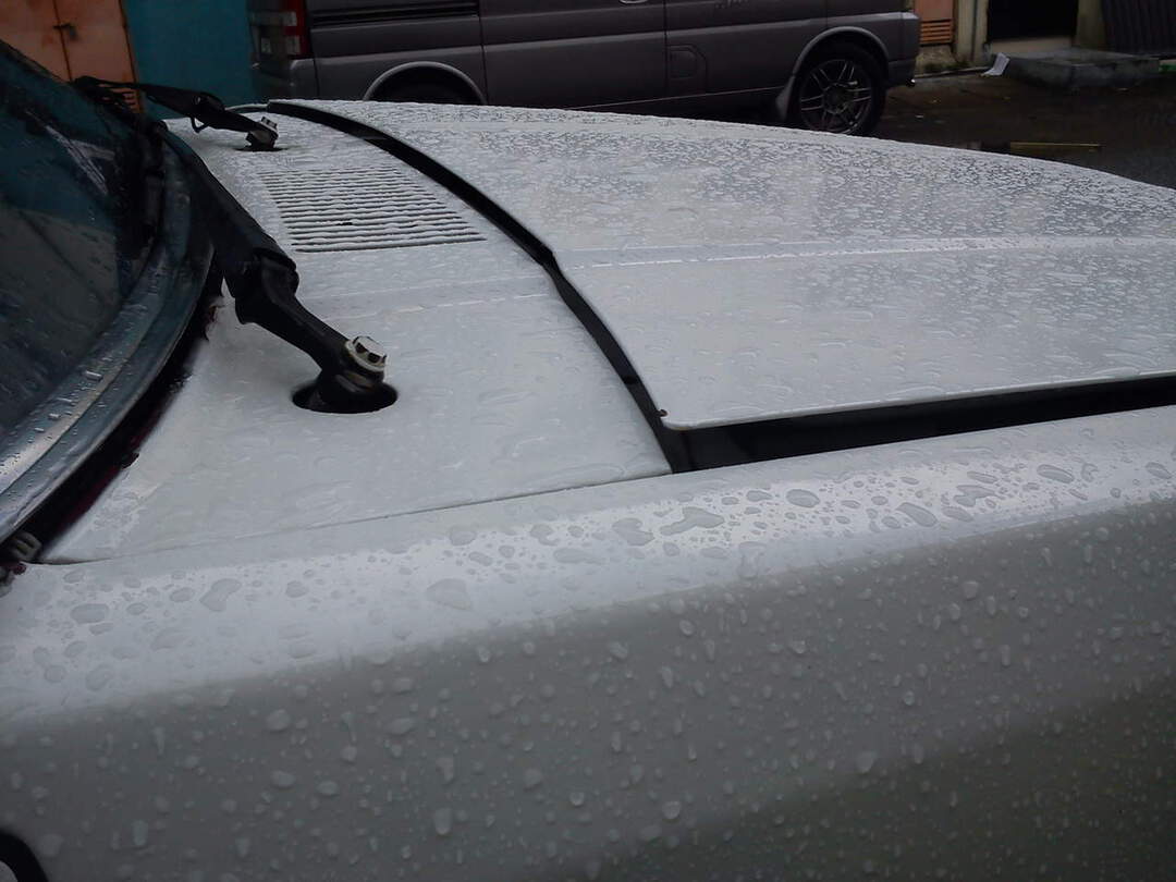

How to raise your car hood.. DIY style
These are the things you need :
1. a few cloth.. an old t-shirt also can..
2. 4 screws.. same size & thread with ur hood screw.. but you need to get a longer one..
3. a few nuts.. this one u need to get 1 size bigger than ur screw.. it's hard to do if u use the same size..
4. an empty can of spray.. or whatever (i'll explain later)
5. a spanner.. of coz..
1st step..
Wrap the empty can of spray like this & place it in between your hood & car body.. make sure it fits tightly.. this will prevent your hood from crashing down on your car..
2nd step..
Open 1 screw & go to a hardware store & get a longer ones.. if your screw is already a long type, lucky you :biggrin:
Also get a few nuts that's 1 size bigger then the screw.. so, it will slide through the screws..
3rd step..
Put the nuts in between the hood holder.. MAKE SURE YOU DO THIS 1 SCREW AT A TIME.. as u can see there's 2 screw on the hood.. loosen 1 screw & work on the other one.. the number of nuts determines the height of your hood opening.. tighten all screws once u finish putting all the nuts..
4th step..
Repeat the steps above on the other side of the hood.. clear all your stuff from the engine bay, close it and u'll get this..
Happy DIY-ing
& Gudluck :burnout:
