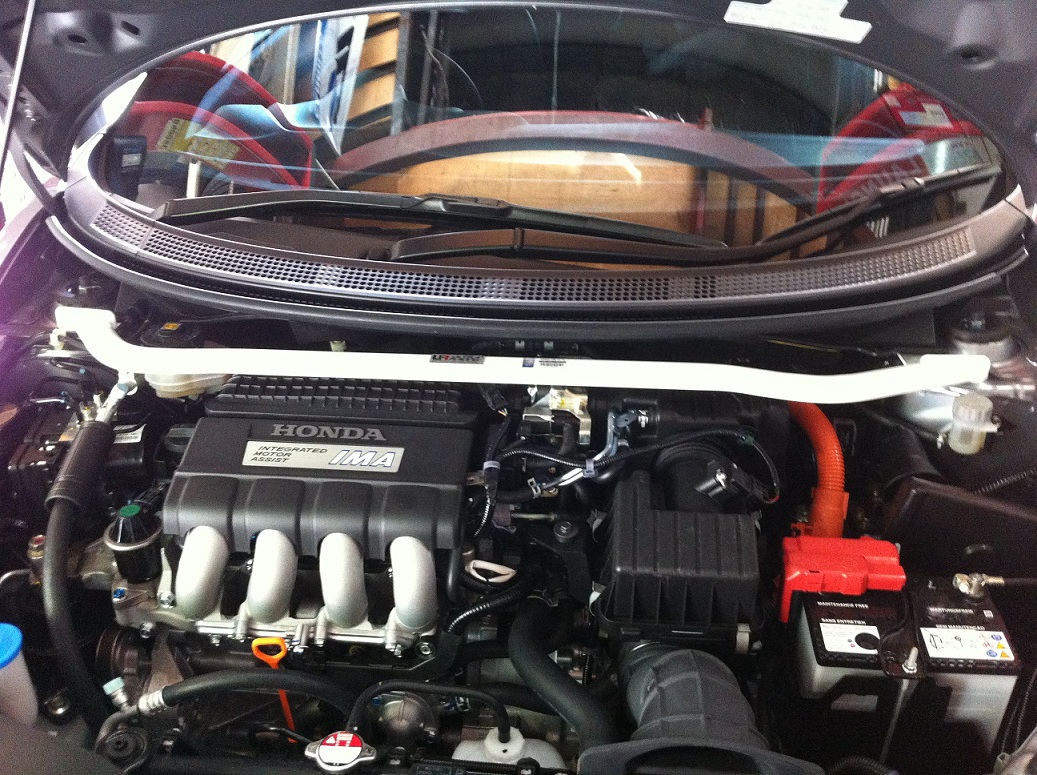

One has to be careful with UR stuff, I used a lot and it DOES work but this time for my CRZ, I am shocked. The UR tower struts probably give a 2.5% improvement. Hehehehee ... can hardly feel the difference at all.

Strut tower bar is straightforward, hard to mess up. But many of their bars are questionable. But a lot of people buy it and feel good afterwards. Whatever rocks their boats I guess :)
its alright in the engine bay. I'd personally recommend giving it a coat of lime green paint or something. now its just mundane in a sporty looking CRZ

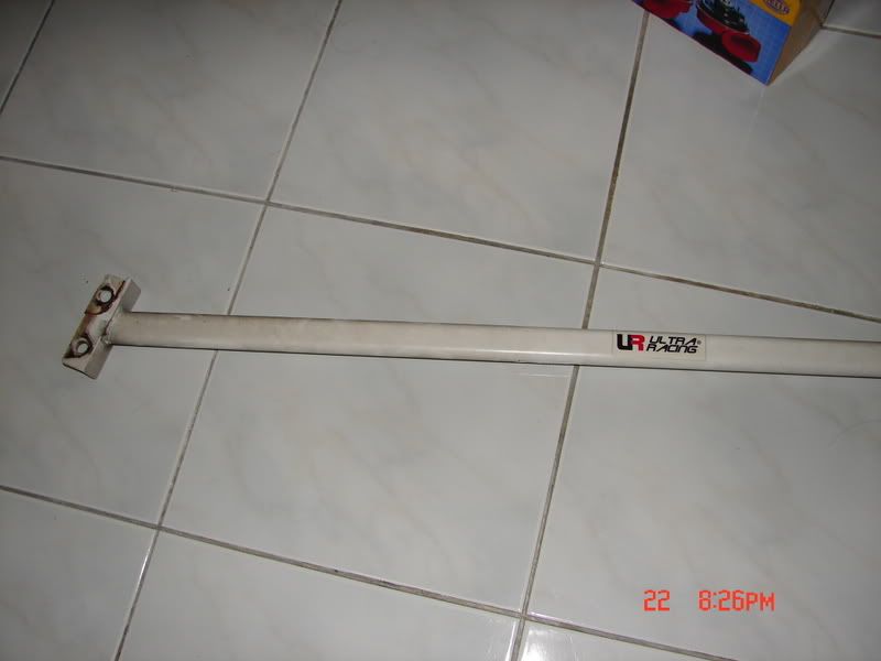

ixeo, I disagree with your statement about your last picture. Torsion beams are not solid pieces of metal like those found on trucks. They were designed to just hold the frame in place not as a strengthening piece. When cornering hard or not, these beams flex and that contributes to the bodyroll. Adding a "torsion beam strengthener" (not anti roll bar) just lessens the flexing.
I would agree that some bars are a complete waste of time but I disagree that this bar is useless. It's not as affective compared to a car without a torsion beam running on a antiroll bar, but it works nonetheless.

Concerning the CRZ front strut...they must have a reason to bend it that way...mayb to avoid some parts or to create some stiffness at some point, i dont know...wish there's a designer of UR here :rofl: or someone who can simulate these using a software like NX6 :rolleyes: kinda regret i dint really learn simulation software well enough last time

CRZ engine bay is tights due to sloping design. So that is why UR took the easy way out. A good tower strut solution is by Spoon, it's a 4 point cage. Now I know why they went that route. Drive the CRZ gently and you can get about 20 kms/liter ... Not the most amazing but it's very decent. Also a very fun car to drive around.

Agreed. But the UR bar in the picture is NOT an anti roll bar. Say what? Again, look at the mounting points.

Correct. ARB connects left and right. But again, the item in the picture is not an ARB.

the torsion beam IS supposed to flex. it was designed to flex. why you stop a part that's supposed to flex from..well, flexing? get what i'm trying to say? the anti roll bar, that's a different story. again, look at the mounting point! then draw out on a piece of paper and imagine during movement what will happen. take into account the mounting spot and the thickness of the bar and compare to ARB designs.
HINT: if you STILL can't figure out, just imagine an ARB that is 3x too thick and imagine what will happen.
Is the point supposed to move? Or not? If its supposed to move why are you bolting the left to the right? LOL. A anti roll bar is not that thick and its designed to flex to a certain degree.. instead they came up with this..[/QUOTE]
I dont know what you are trying to say here, but i believe this is a lower arm bar. And an anti roll bar is of course not as thick as this, the these two bars are mounted very near to each other in most cars. Believe me, i have both and they work well. I guess i dont have to explain what's the difference between these two, as u had done ur research.
I dont knw the operation of UR and how does the company comes up with their products, but i'm kinda sure there's someone who designs the bar. Engineers or designers, you name it. R-35 is designed not by an engineer, but by a sales dude who ended up in plant production. If you get what i mean.
I guess you are smart enough to get a proper engineered lower arm bar at a very smart price. I have to admit, I do not know how proper is the proper lower arm bar is engineered and how rubbish is the improper lower arm bar. Never used both before and never simulate/calculate before. Since you know, mayb you can share your facts instead? Dont get me wrong here, as most people do think higher price item is better. Smart people buy dont buy rubbish, idiots buy rubbish, at a high price too.
On that article..its kinda contradicting with the statement you provided. In the article it states that stock torsion beam is designed not to be too stiff to make it fool proof. Adding an arb will reduce the flexing but too stiff a chasis will have the tendency to "lift" one side of the car up. Regarding the picture you had posted, what car is that and where did you get it? It seems to be a problem with the installation (my own opinion, of course). See the mounting point. The end of the bar is a round cylindrical like thing which should be bolted on horizontally and not vertically. But in this pic, it seems that the user installed the lower arm bar where it should be anti roll bar. And the bar shape looks flat, not round.
izso: regarding rear lower bar, imagine instead the same mount point was WELDED by the exact same piece of metal. will the torsion beam still flex? that's the same effect of the UR bar anyway. except its bolted on, but there's still no give/slack there, its effective as welding it.

You seem to understand, but at the same time I'm not sure if you do.
The car is a Myvi
The product is UR Rear Strut Bar or Rear Lower Bar or whatever you call it.
1. What is the function of the rear lower bar? Stop flexing
2. What is the function of anti roll bar? Reduce roll to a certain extend by reducing flex, the thickness affects how much roll/flex is reduced. The ARB will still flex.
3. What is the function of torsion beam? To flex, as per the article.
3+2 = reduced roll, one is trying to flex, one reduces flex but it is still flexible, ARBs are very thin, for myvi usually 16mm or 19mm in diameter.

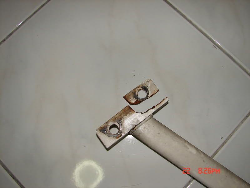

3+1 = one is trying to flex, one is trying to stop flex entirely, that rear lower bar WILL NOT flex. look at the thickness. its same gauge as the front strut bar. so the force from the torsion bar will fight with the lower arm bar, and see which one fails first. And guess who wins?
lucky the torsion bar worn, else its gonna be a very expensive bill.
so.. draw your own conclusion if the rear lower bar is rubbish or not. :smokin: I think its pretty clear, can't help if you catch no ball.

Ixeo, even with the bar in place it allows the torsion to be flexed la. There were two models, the 16mm and the 19mm one. The 19mm one was the one that was ripping out the bolts and all because it was too stiff (exactly as what you said with regards to the welding) but the 16mm is just nice and still allows for flexing. Let me do the experiement and take a pic. You can see for yourself. Anyway, in terms of feel, nothing beats the ARB in my Wira but that's not the fault of the bar, it's the chassis design. Me no likey torsion beam.
