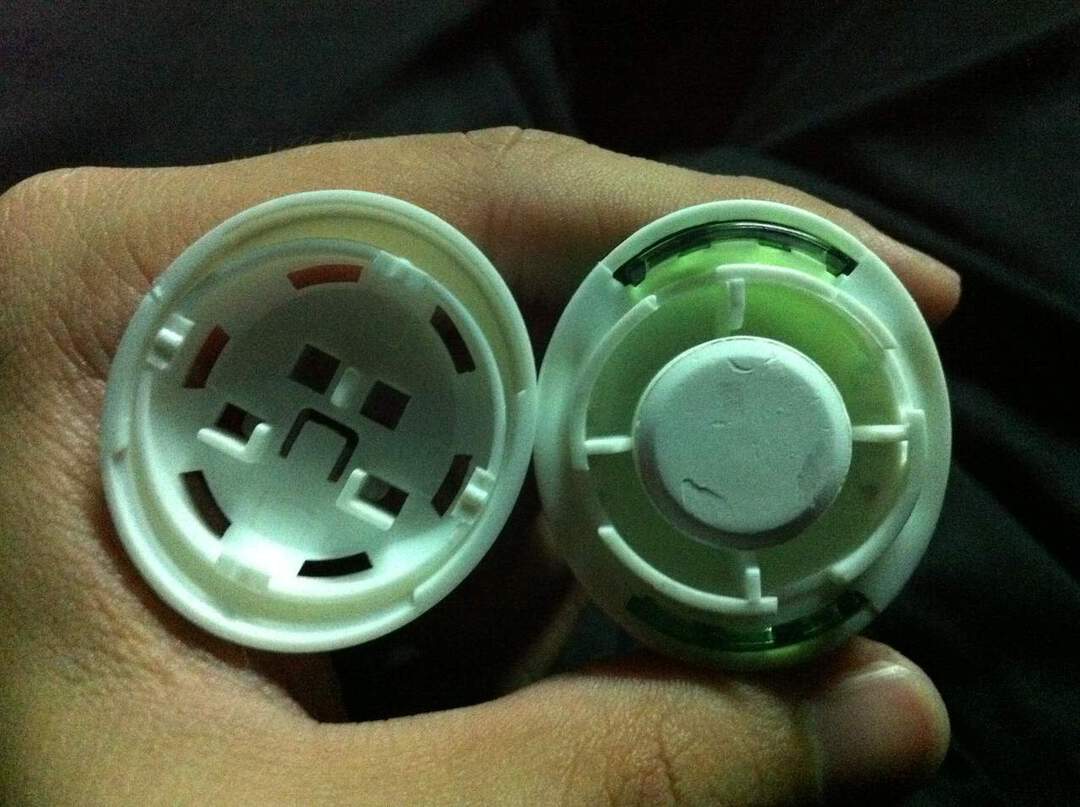

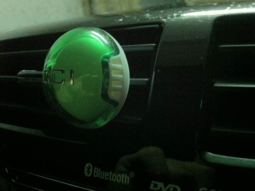

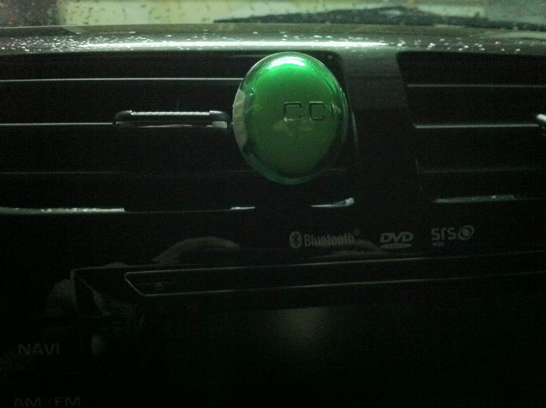

Oh ya I got something to share...not really a modification but at least it makes ur car interior smells better and at the same time you can still adjust your air con diffuser. Can be bought from TESCO and ENEOS. I bought it from TESCO...RM12.90 and comes with two fragrance pellets. You can see the middle is the pellets...but it doesnt state how long it can last though...I'd used it for 1 month already and it still got green tea smell comes out :rofl:
