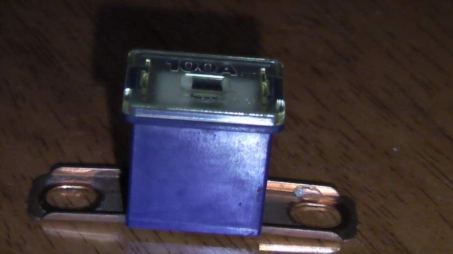

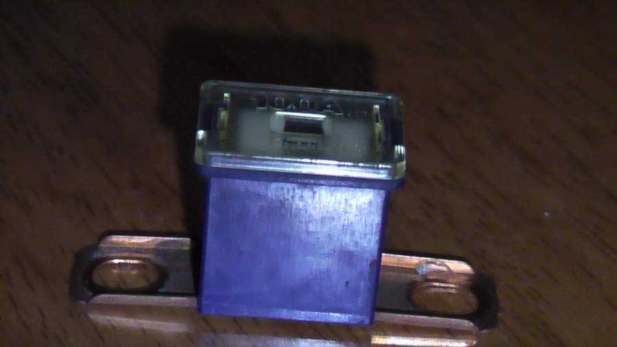

Abang PutihSemua,
I believe your car cannot start due to this battery fius kot. Can buy at kedai bin potong at RM10 each. Make sure it's 100A one. and make sure unplug the battery cable first before pasang. Got 2 screw to bukak and pasan balik.

yup, u are right....
the battery fuse putus, gave me headache to take it out, the fuse was screwed to the board, really stubborn to take it out.
at first i thought it just like any other fuse, just take out and replace, but apparently the fuse is screwed to the board, really hard to unscrew the fuse (habis basah baju kena peluh)......
but i didnt cabut the battery terminal (tgh kalut)

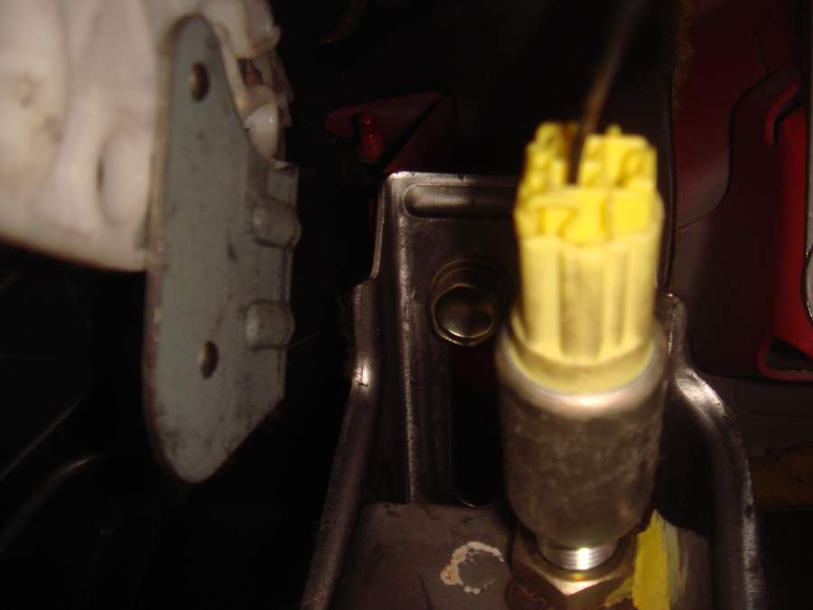

my 2nd DIY ka....hmmmm.....taaadaaaa.......
yeah...sesi berDIY.....spesel for Euro R and CF4K who installed clutch starter system on their car......DIY starter switch heheheh...
Bahan bahan yang perlu disediakan:
1. switch 3 kaki (2ways) x1
2. switch 2 kaki (1 way) x1
3. Wire around 2.5 metre (AWG24 better)
4. pembogel wire (wire stripper)
5. soletep hitam
6. gunting
cara2 memasak:
1. Open the cover bawah steering tu, dun know the name hehehe
2. Find a yellow connector around your clutch pedal. The connector have 2 wires installed connected, a blue and black. (refer picture 1)
3. take out the connector or kalau malas, just cut the wires from here.
4. Then make a connection circuit like 2nd picture attached.
5. After that, you can install the switch anywhere u want. for me, switch 1 (SW1) was installed beside foglamp switch and switch 2 (SW2) was kept at secret place.
6. then pasang balik connector to the place, and pasang balik cover bawah steering.
advantage(s) with this DIY:
1. When SW2 ON, you can start the engine without need to press clutch pedal, so dun need to enter the car...just start from window lah.
2. If u park at shopping mall or house, switch OFF SW2. then bad people will susah to start the engine....
sekian dari saya
