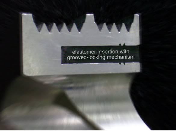

as we know there is a crank pulley price at RM600+
as they claim the rubber damper help to absorb and dissipate the vibration.
material use by this crank pulley is T6 6061 aluminium alloy, as we all know this material is light and very strong(stiff)
does this rubber damper really works? how long this rubber can last....
most of the aftermarket maker is use full alloy
i'm not complain their product but just feel abit over price....

guys is there any of us from engineer background?
yup, those rubber really will absorb some vibration. as same as ATI product.
