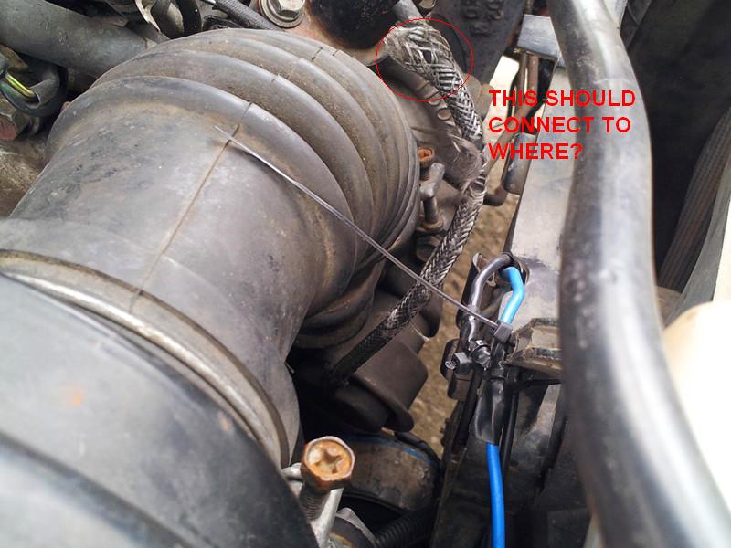

Hope sifu sifu here can help me with this, recently i just get a wira VR4, I still new in turbo world. i have 2 question.
1) i notice the hose is not connect to any where. so what i worry is the boost wont release.
2) Does VR4 4g63 also original come with TD04?

dat vacuum shud be connected to the actuator, r u experiencing boost cut when driving it hard tak?

The actuator should be connected to boost source. Any part between the compressor outlet to manifold. If it's not connected, may experience overboost.
The difference is the turbo and ecu.
