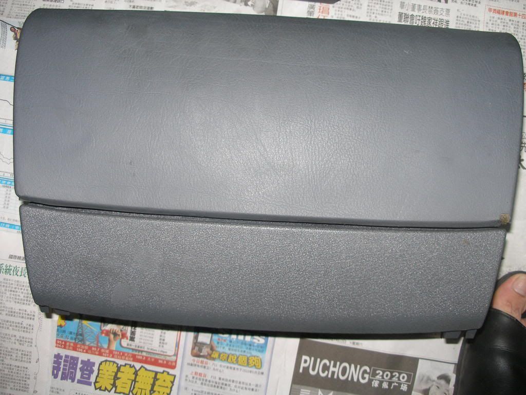

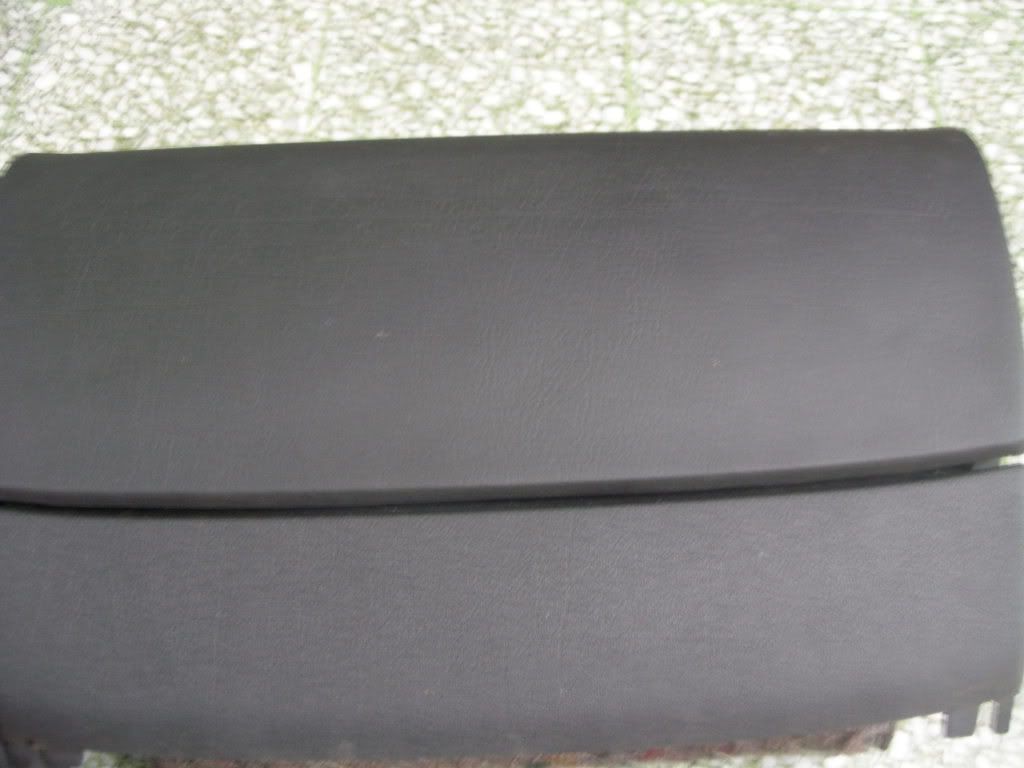

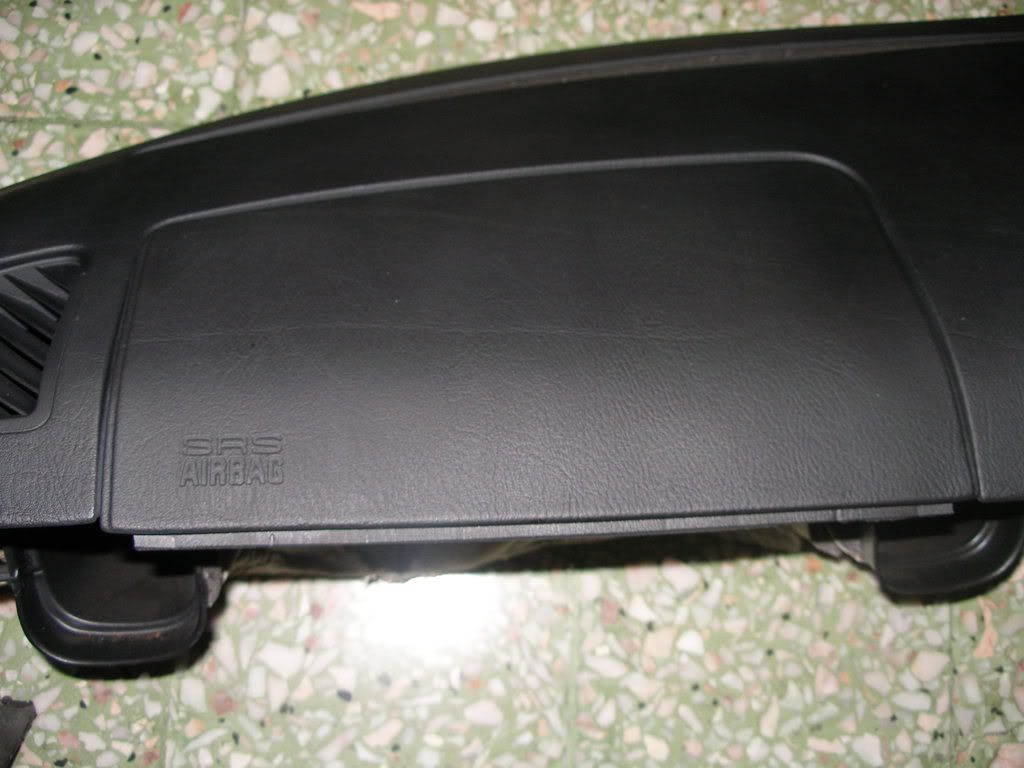

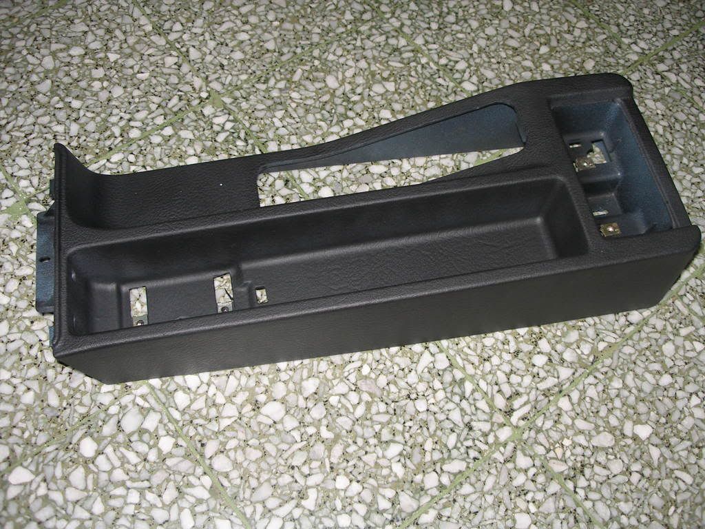

wondering whether it also can b applied on door trims?
wat car u referring to?should be no problem,but remember dun spray too much,a thin layer of paint will be enuf.
Mirage CA1A doortrim... because there are two parts, the whole trim is vinyl and the pocket is plastic... Can be applied on both surface?

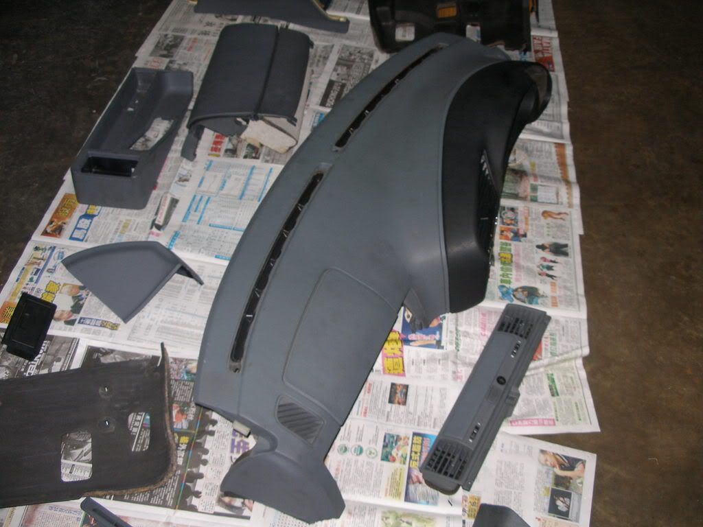

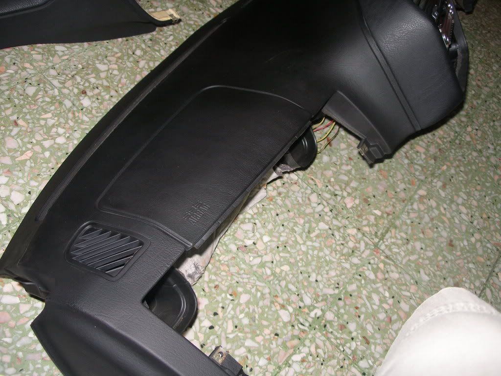

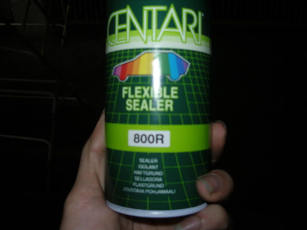

1) clean the dashboard with water
2) clean it again with petrol
3) spray it with "flexible sealer"
4) spray the colour u want before the "flexible sealer" dry
5) done
im not salesman of CENTARI or SUNLIGHT & happy DIY my friend!
