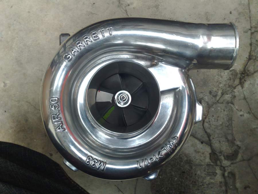

wait,this is my ar50 pic..
so what your commnt?
back(bontot) turbo ar63..

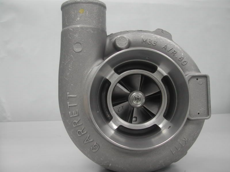

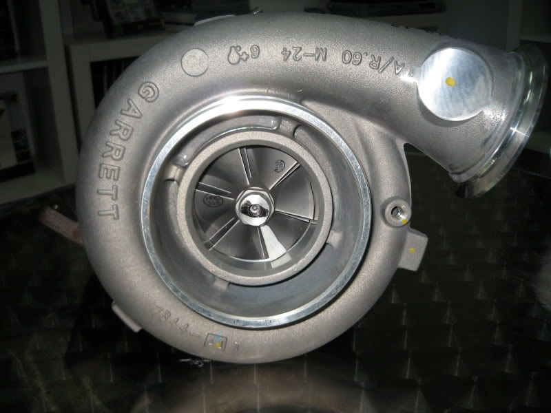

a very good example, if u say ar60 turbo
it could be a t28 turbo ar60
it could be a t04e turbo ar60, compressor wheel 46mm , 52mm, 54mm , 56mm and it goes on
http://img413.imageshack.us/img413/4648/p1010003xr0.jpg
it can also be a gt28 or gt30 with ar60 housing
or it could even be a gt42 with ar60 housing
thanks sdf for pics
so u can see above, all turbo's are ar60 front housing and they dont mean much if you are asking how much u can boost and which turbo will be best for 300-350m
all turbos are suitable for diffrent car for a diffrent car for 300-350m
looks like a t04e turbo, bt it could be a gt28 also
is it ballbearing or normal , err and who is selling it :D
from that can know the full spec
Bump: cant really say much
cos it looks like a custom turbo
must ukur the front fin and back fin size :)
bt .63 t3 is just sweet for a 2.0 , maybe lil sacrifice at the top end
maybe SDF can give more info on this tmrw in the morning :) , he mst be bz with some sexy legs sleeping
i buy at tong turbo..
its not ball bearing trbo..
but when i buy it,die tulis kt banana T3/T4..
Bump: so now yg byk kuarkn hrsepower bontot or dpn?
most common one that tong sells is the
57trim T04E T3/T4
56mm inducer , 76mm exducer
not that laggy on a 2.0 , should bring u to the 400hp range
