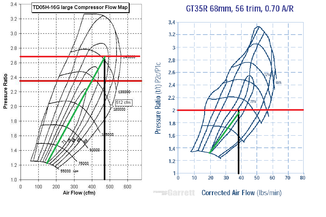

sorry guys,need some info here
TD05-16G(Big) and GT35 is too different devil
I just want to know,am I reading the compressor map below correct
GT35(ar70) at 1bar boost = 38[lbs/min --> 487[cfm]
If convert the same airflow to TD05,the airflow into the engine is equivalant too TD05-16G boosting at 1.6bar considering the efficiency the same
attachment.php
p/s: the reason i'm asking is because just want to know maximum boost i can dial in with GT35 on stock evo engine(Repeat : Stock internal piston/conrod) fueling is ok. on RON95
to be safe...try stop at 550-600cfm flow...since it already maxed your td05...and gt35 still have plenty of breath on that...
i would say keep it around 1.1-1.2bar of gt35...
but since most of engine hardware...i think gt30 is a better option
