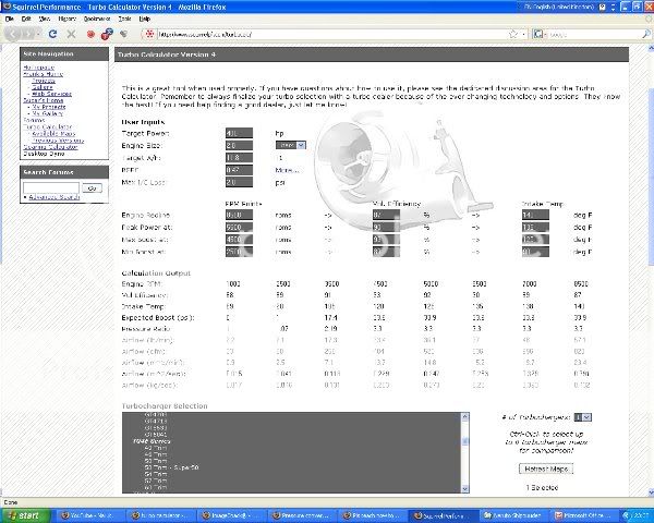

by mean to do assumption, i must plot myself graph at comp map...? hmmm... i'm such :stupid:
if i use GT3071R in 2liter engine, expected power at 450hp, af 11.8, engine redline 8k, peak power 6k, max boost 4k, min boost 1.5k and i must boosting at 2.13bar, i just get 450hp...!!?? is it make a sence...? if 2.13bar in stok block, sure crack the sleeve/piston rite... it was not the temp, but it's coming from pressure...
max i/c lost... how to get this...?

bro intercooler lost usually i used 2psi- pressure losses through piping..
bro there is several way to calculate compressor map..which one u r using?
u cant use 1.5k min boost..cost at 1.5k it usually still vacuum..normally boost start at 2~3k rpm
select Expected HP 1st THEN SELECT COMPRESSOR...:listen:

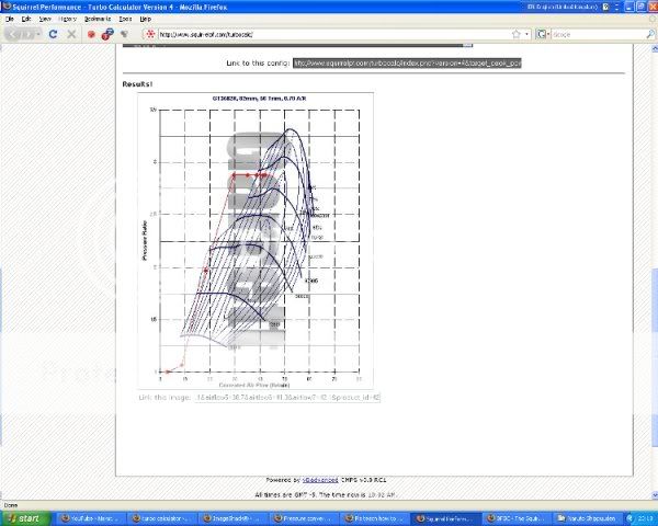

at the box, it's stated like this... GT35BB, 7145680002... and tag at turbo KA7036... 0.82inch at exhaust side (i'll snap some pic if i could catch some time)... i assume it as this... GT3582R... as bebolasgalas T said AR is refer to ratio compressor housing, AR70... 82mm, 56trim, 0.70 A/R... is it..?
http://www.squirrelpf.com/turbocalc...8.7&airflow6=41.3&airflow7=42.1&product_id=42
ok... like this... if i put HP 650hp then the boost is 63psi=4.34bar... 500hp ---> 45.5psi=3.14bar... 400hp --->33.9psi=2.34bar... somehow 2.34bar boost i believe will be limit

bro 1st thing.. u said u want learn how to calculate not how to use software..i already used the software and now i understand u dont know wat r u doing :D
OK...IF U PUT 650hp from engine 2L of cause u will get that kind off boost..in other word 'un reasonable'..this is because ur afr is still standard engine (pump gas not alcohol)...ur bsfc still unchange..how come u want to built 650hp wit stock motor..of cause u need very high boost to make power..the software calculate wat ever u put it in..so if u put unreasonable data..result should be unreasonable tooo! u already know wat..:love:
like i said be4 the is several way to using comp map..software that u r using is try select turbo based on hp u want wit motor u used...understand the software bro...learn how to calculate manual 1st then u can understand the software...

COMPRESSOR IS TOO BIG FOR UR ENGINE SETUP..SELECT SMALLER TURBINE..POINT FALL IN SURGE AREA
what u meant by that sir... what software do u use...?
how do u know... by your experience or based on graph...?
YES BRO..NOT MY EXPERIENCE BUT MY KNOWLEDGE :hmmmm:
