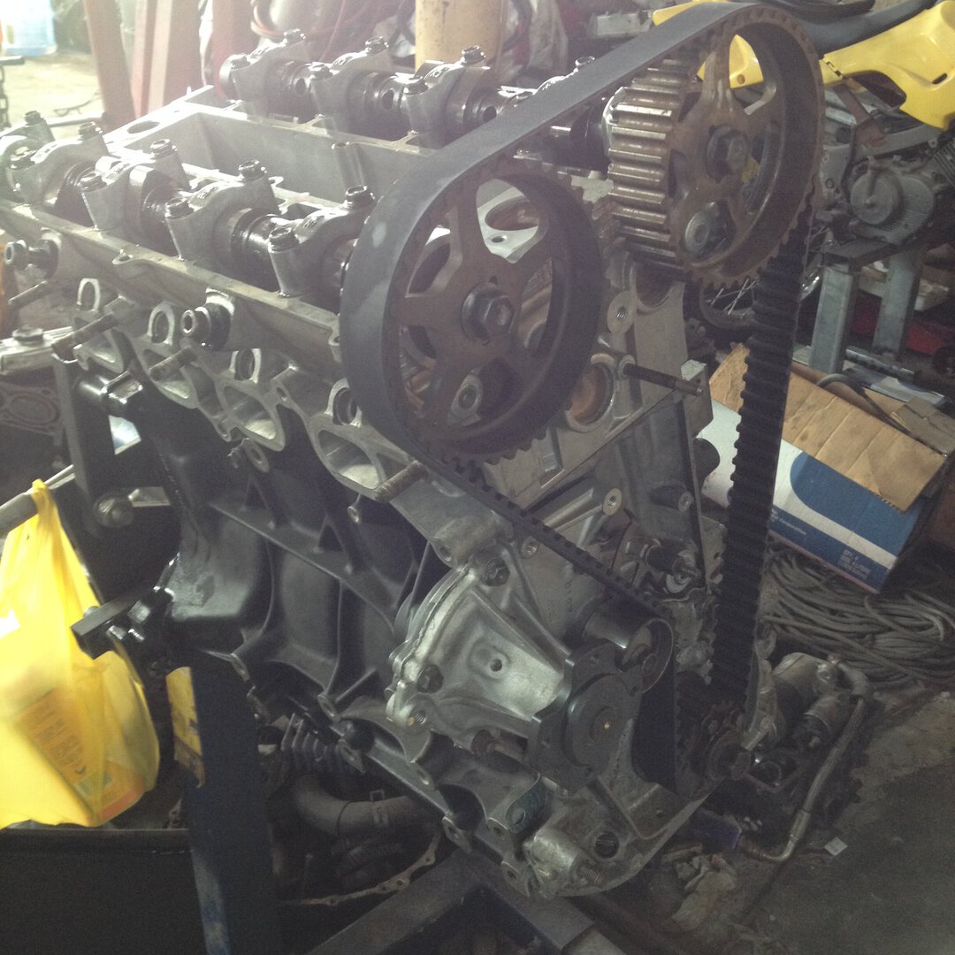

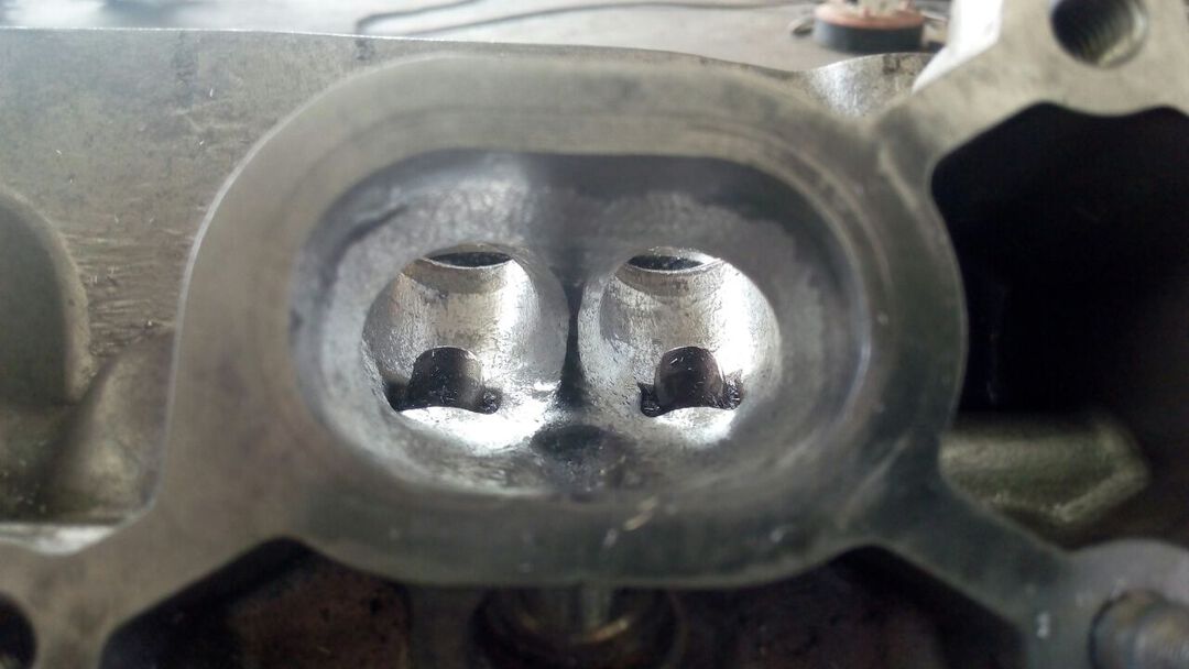

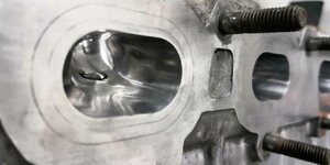

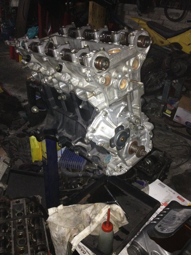

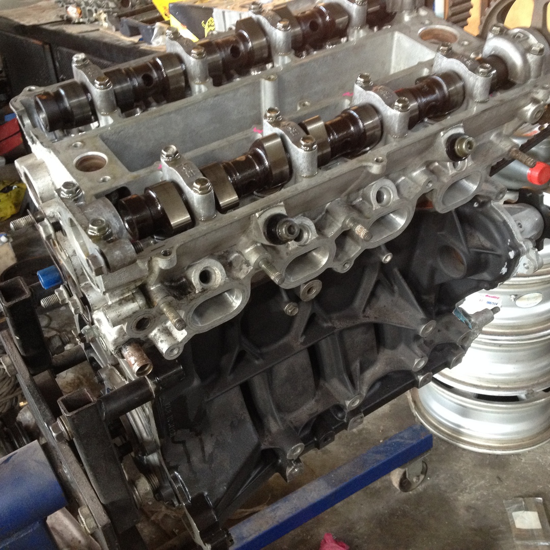

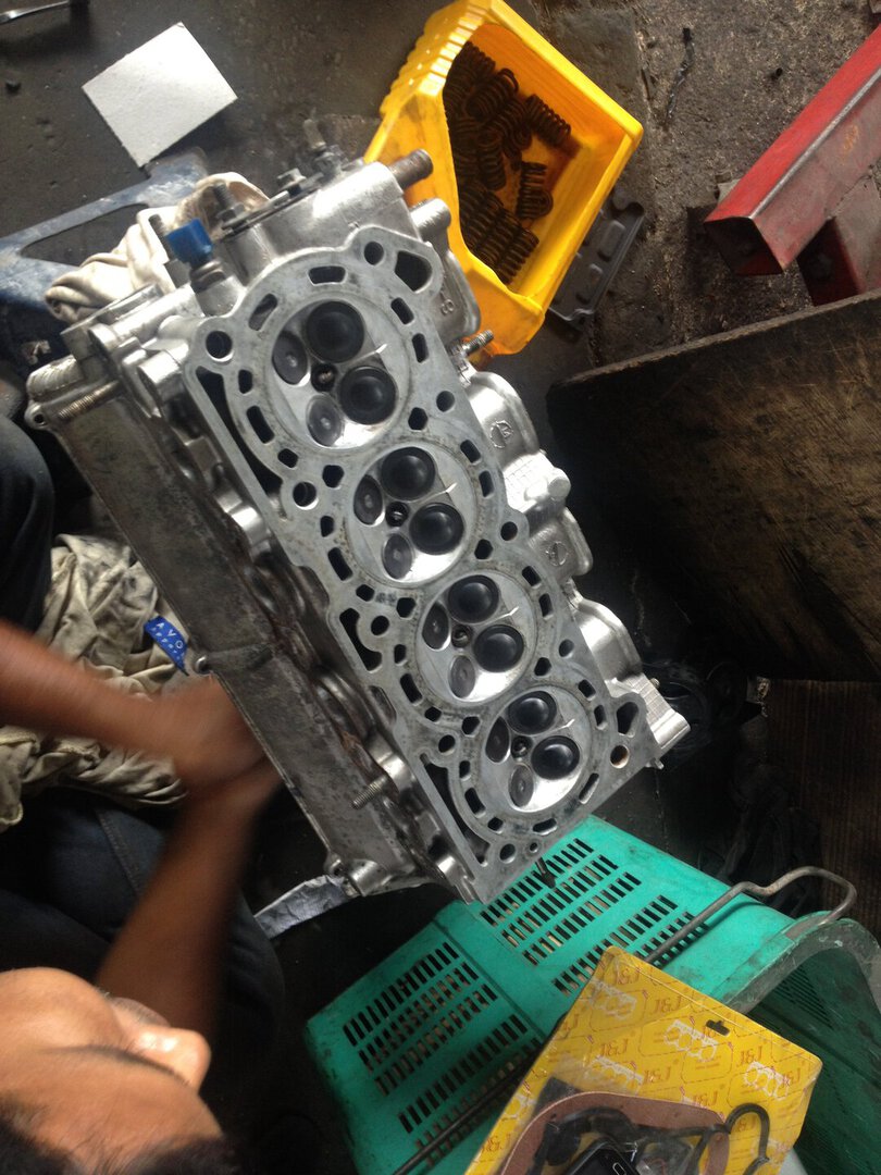

After done for bottom side, we go through to upper section, not much for R&D on g13 head,
but willing to share with everyone...
Valve size - Stock original suzuki
In / Ext - Polish
Volume Chamber - None /
Singh Grove - Intake side
Cam Spec - Rally/ Race (Tighe Cam)
Lifter - Hydrulic lifter
TB / Stock - Gadgetman and porting
All internal seal / Original Suzuki...

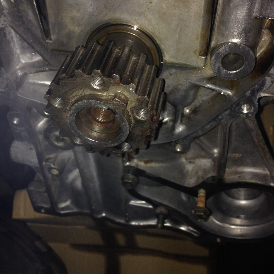

Standart cam shaft for finding normal idle and running...

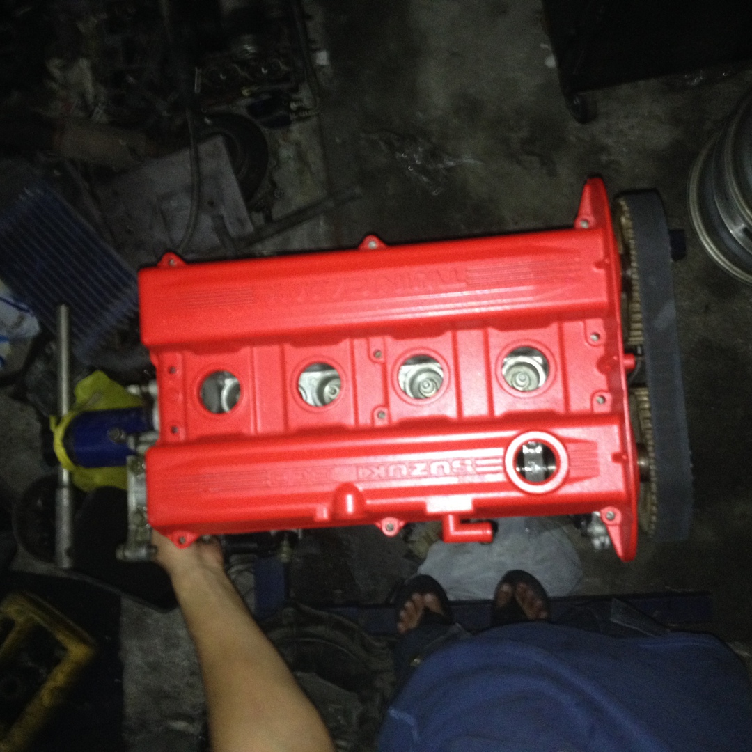

Rocker cover arm after painted red wrinkle colour, (finishing like sand paper)
Detailing for rocker cover

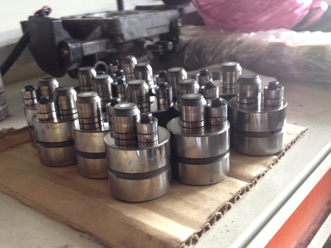

Lifter after services (Please be very carefull for this job)
Inspect and mini discus (ending the whole day just only do this job and have a tea) :smokin: :laugh::laugh:
Please find accurate torq wrench and do calculation....
Simple job only, just wanted to get better flow and good amount of combustion...
(used part only) maintain the main objective...

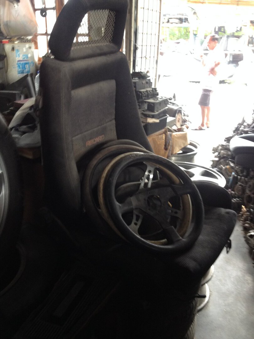

Off topic temporaray lets we discuss about this picture... I start with recaro fishnet nowsday nearest hit 2k complete and in good condition.
lots of steering wheel to choose... where do you plan to wrap the steering again? any recommended shop?
That steering when i do site visit, if im not mistake their has one malay guy who make refurbish back for fabric automotif part, at selayang... their only do for fabric part, seat, steering wheel, door panel, roof and many more.
Any kaki one who always swap for OEM sportrim for their car ?
Conti. OEM rims look cool some times, but avilable in big size only haha

mind to share the guy's contact that doing rewrap? looking for some

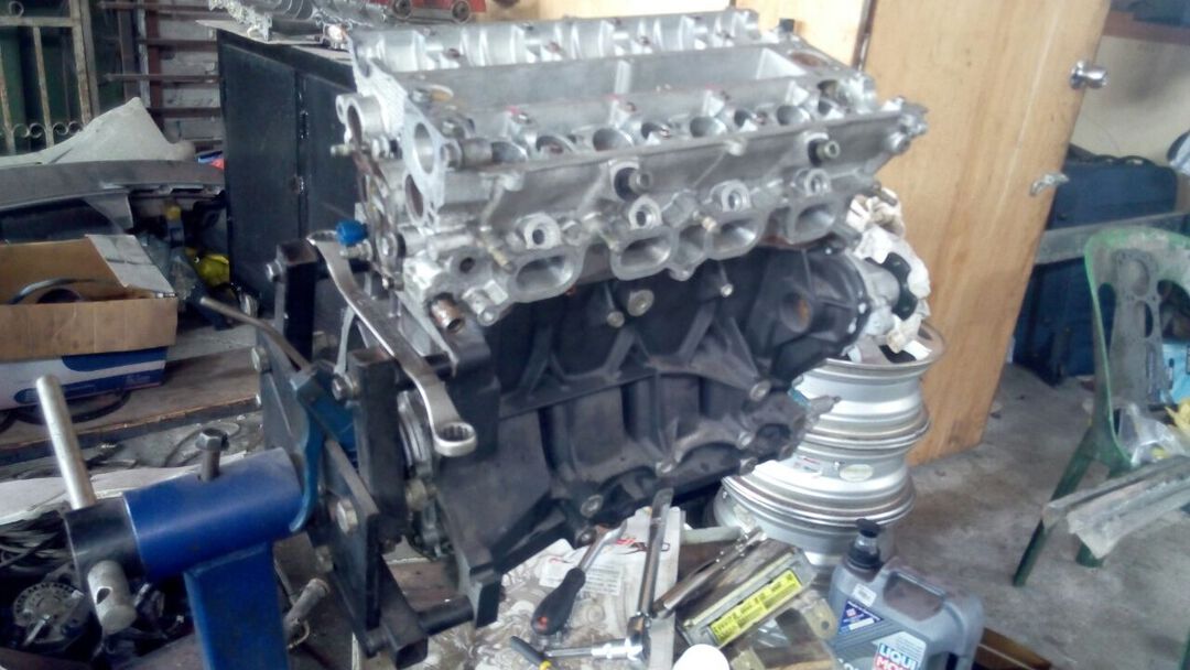

Asembel all the bottom and upper component.
process with simple and fast schdule / upper component * dismantle - replac.& modf. - build up.
/Bottom component *dismantle - replac.& modf. - build up.
you component exmp, strud nut, bolt set, do in torq wrench calculus. please don't piss just hundread buck cause of simple shit.
and construct upper and bottom just in one day equal to rest, hahaha:smokin:
*all you tightend and all you lug bolt and nut if you have manual book please follow perhaps you has build extream mody importance
to do some calculus first...

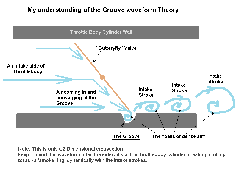

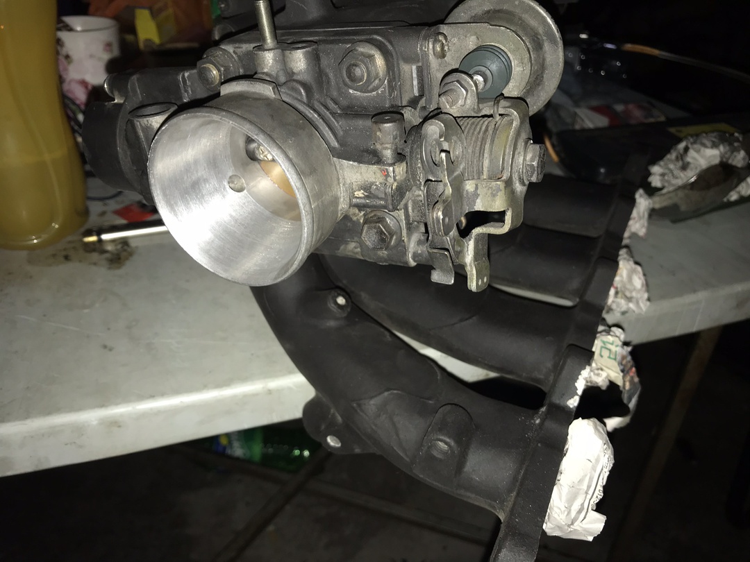

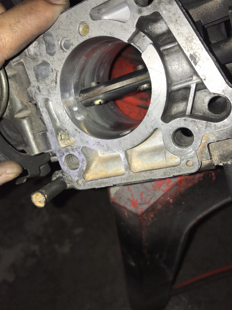

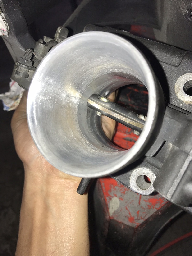

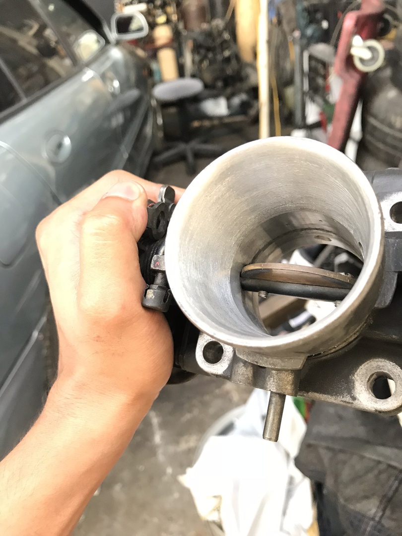

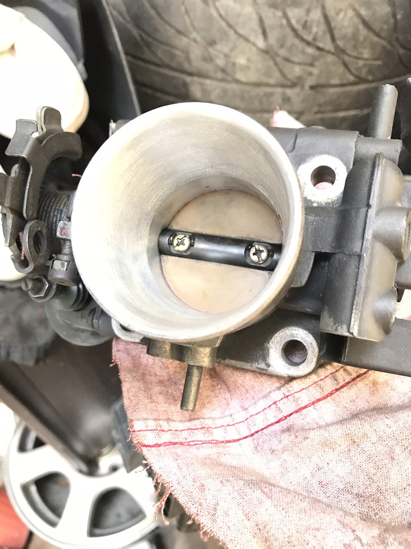

ok, this time i post how im doing about my TB and manifold.
Info spec : GTi manifold
Descrp : ermmm maybe we can call it non oval shape, this one its diffrent with other one swift manifold called (cultus)
Inovation : hahaha, i do some gadgetman work on my TB, my expectation to create a great turbulance system.
see last picture. (we can discuss more)

The turbulence mod might work but the turbulence created will be gone after a short distance, maybe not even halfway down the intake manifold.
Just have a look at some aerodynamic video on YT. They are testing at higher air/wind speed and whatever turbulence created is gone after certain short distance. Yes your TB and intake system is closed system but the same concept applied.
Ermmm sound reasonable too, What in you mind think if the flank its shorten ? from my oppinion turbulance that create its more for giving forced air into the combustion system. "create wave wind intake stroke"
:emoji_thumbsup:
:emoji_thumbsup:
That i cant answer but i still think it does not have any effect. This is advanced physics + fluid dynamic + calculus.
Just to share, an automotive student did a test/study on the spiral intake thing which claimed to provide better power and better fc. Test is done with a dyno. I know the device is commonly fitted before the TB but I dont recall if the device is fitted before the TB or after the TB for the test.
The result?
No gain at all but reduced a few hp and Nm on the dyno.
I think the vacuum generated by the piston going down in the cylinder does not like any sort of restriction in air flow, just like our vacuum cleaner at home.
The result?

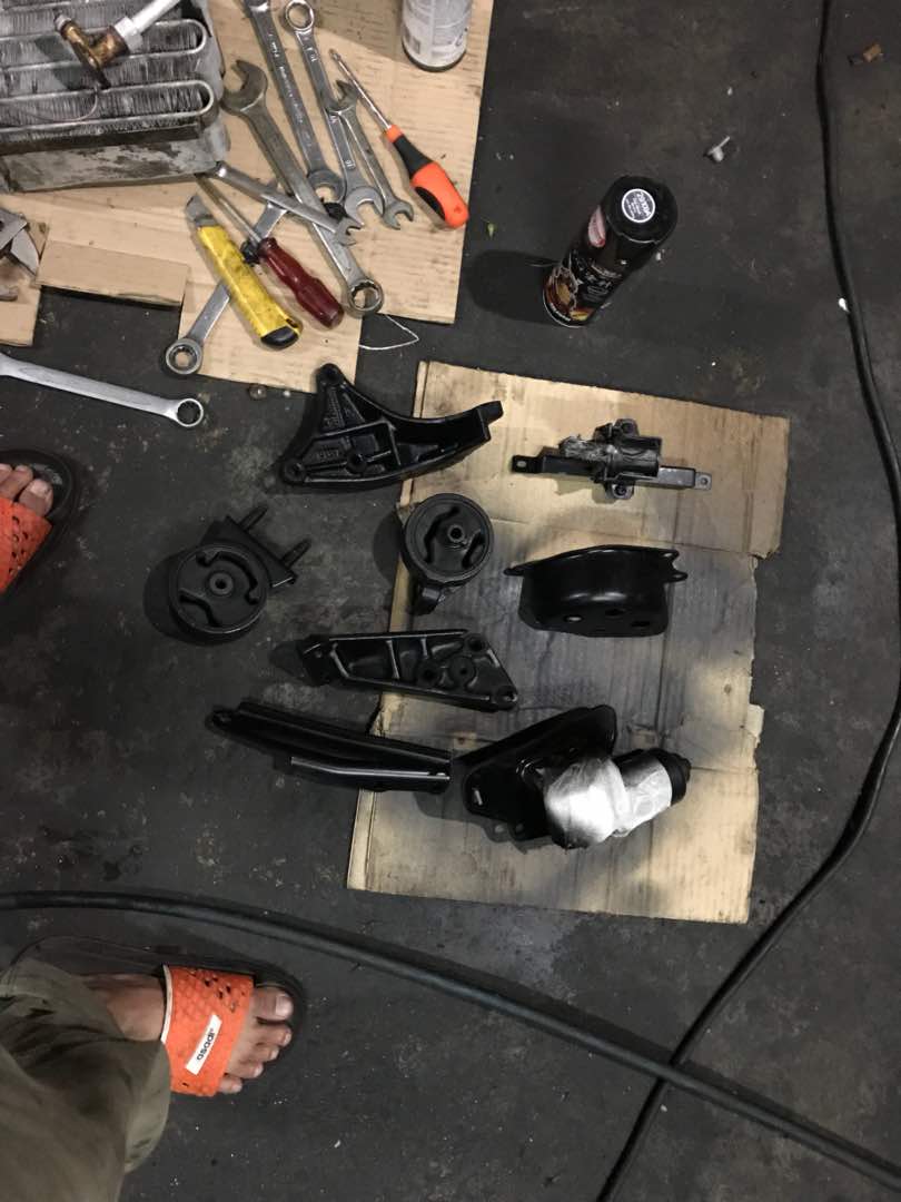

Bracket / mounting and some important part for hanging my Machine..

Bring it on new Horespower
Get new from Mun Lee / TQ Nissan....
Not in proper align / Rough step first
Of course new drive shaft after new horsepower bring in...
