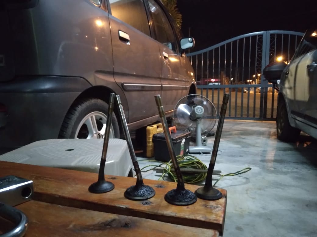

Lets see what the intake valve are like. This car got 16 valve and i cant get a pic with 2 valve per cylinder. Below are one of the valves from each cylinder. They are in the same condition;
I guess Caltex with Techron does work eh?

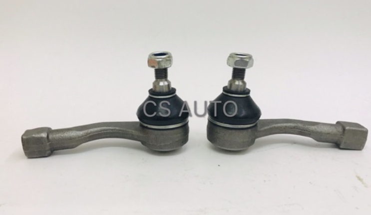

I just finish DIY replace the arb link and tie rod on my BLM.
When cleaning up i noticed something that strongly suggest i might have f**k up the simple fix.
The tie rod, some car comes with tie rod which have curve in it while some are just a straight piece.
BLM one have curve.When replacing the the tie rod i just removed and re install according to how the original piece ( on the car since i bought the car brand new )is installed. In the BLM case, the curve is facing the rear of the car. After installation is completed and while cleaning up i noticed there is an 'L' and 'R' sign on the tie rod plastic packaging ( i bought one pair and its packed individually ). If i were to follow the L and R based on the marking on the plastic bag then i have installed it terbalik which is opposite the original installation from the factory.
So, did i f**k up or its ok?
Deep down inside i pray very hard its correct as working at night with bad lighting and not having a hydraulic jack is very stressful....

unless theres an obvious design difference... long as doesnt bind i think u will get away with it. at worst maybe the screw adjustment thread is terbalik (maybe)

You should probably redo it. I dont think they purposely make Left or Right without good reason. Something should be in the way
