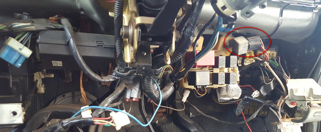

Hi guys,
i have a one speed all the way wiper problem.
I've even bought and swapped out the whole wiper/signal control. problem still persists.
I read up more and it says could be a relay problem, could someone point out to me with a pic of the relay location?
i PM'ed a seller at shopee, mentioned that normally it is at linkage, I don't think so from my googling. So i went to look at the wiper motor side but couldn't find it.
I looked at the fuse box and i am confused.
So where exactly is it?

Switch on your wiper or turn signal and listen for the relay 'tik2' sound. Trace the origin for that sound and you will find it.
I think its at driver side under the dashboard. It should be visible when u peek from the bottom.

Engine bay I think. That's the only place that has those large relays for Wira.

it's inside the fuse box under your steering column. the box supposed to have a label on the cover.

Fuse box got relay? I think what bro. Izso mention in engine bay, the main fuse box have relays in them.....

Key ON (not start engine), Activate wiper, listen to which relay clicking/ feel by finger. I use this method as last resort.

Manage to find it?
Thanks for telling Me there are relay there, but i Dont hear tik tik tik sound when i turn the wiper on.
Is there a possibillity if there was no relay there in the first place there wont be tik tik sound?
Doesnt seem Like it bro , i googled the relay pic , And i Check engine bay Area at the small relay box on left And also the fuse box on right , nothing looks Like it .
Oh use finger, haha ok i try find with This technique, but i am afraid if the previous owner removed it then there wouldnt be tik tik sound
