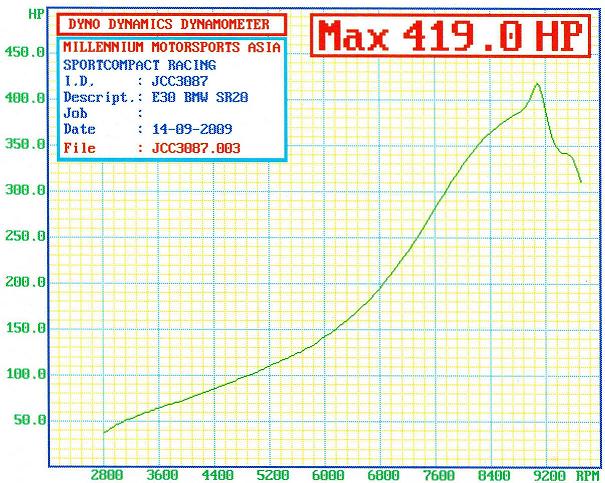

SR20 Stock Engine
550cc injectors
Walbro pump
Microtech ECU
Turbo Bulleye S25x Custom T3 twin(special order from sped spin)
Boost 1.4bar
Whp 419.0
Turbosmart wastegate
Turbosmart 2 stage Boost controler
Dyno Dynamic
Stock Gear Box
