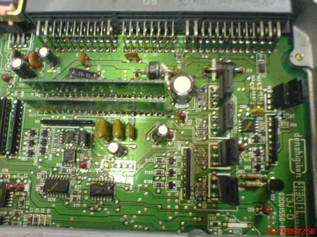

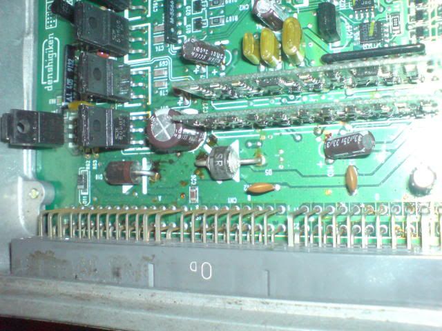

It is confirmed.... your capacitors have leaked and have damage areas near it.
Pls send for repairs and I will try to fix it back to normal....

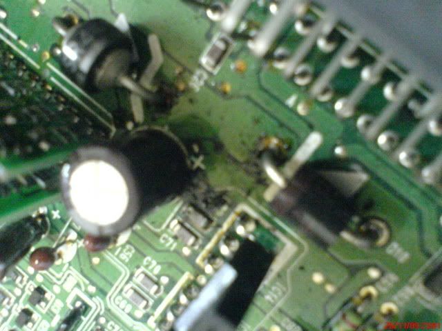

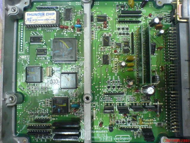

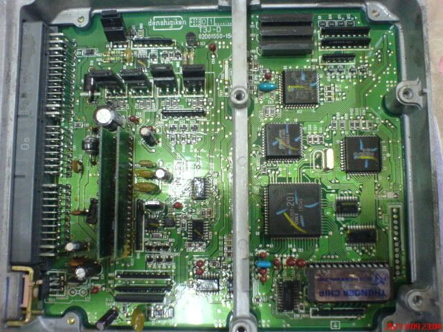

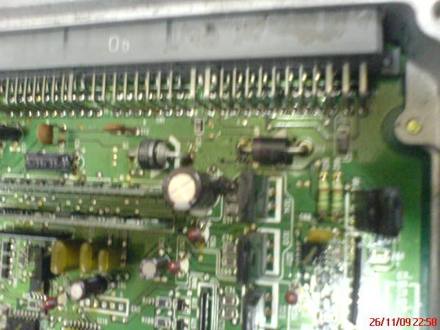

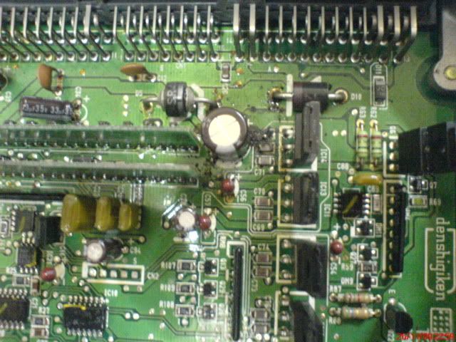

Here is my diagnostic based on ur pictures...
1. Your ecu is P08 auto & has been chipped with Thunder Chips.
(NO KNOCK BOARD)

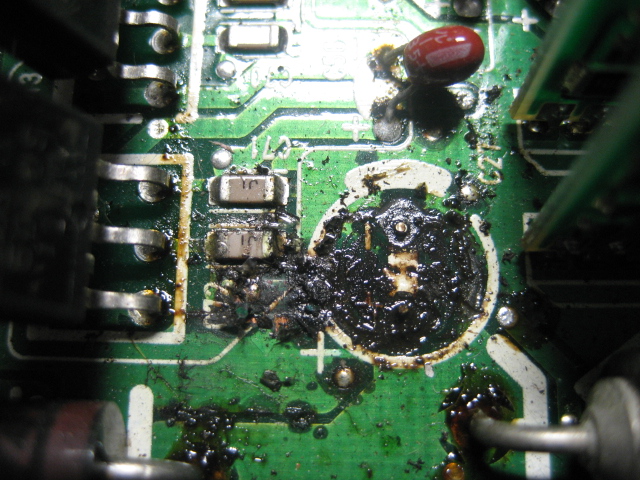

2. Big cap C27 have leaked, nearby chip cap C72 maybe also spoilt.
3. IC14 surrounding areas also looks damaged...
4. Medium cap C34 alos have sign of leak.

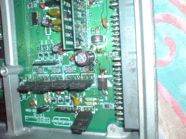

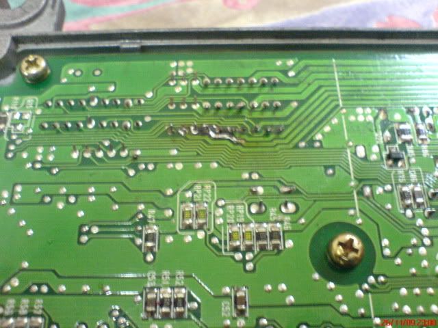

5. Bottom side transistor for injector control QM3 have sign of repair of copper trace...
Tq...
p/s u will soon have fuel and spark timing related problems or CEL code besides your current
vtec cannot crossover trouble....
I am quite confident it can be fixed.... Tq:adore:etech.
