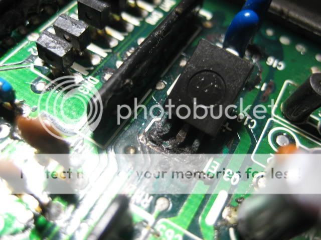

Another nother ECU honda P27 Saved...
Warning!!! Pls repair you caps before leak and cause major trouble..
On 3 Dec, I received 2 ecu's send by member of zth for "emergency procedure" aka repair lor...
P08 with thunder chip for Onconnet- Kedah ( no vtec) and
P27 manual ecu from Pencalat @ calat- JayBee (cannot start).
For P08 I have reported it in another thread. This will be the report for P27...
Report:-
When open up, it was confirmed that the caps have leaked.
Major leak came for C18 which cause major damages.(pls see picture)
All caps (7X) was remove and area clean up.
Near by components was also checked for damages..
After all clean and checking done, some additional ceramic cap and transistor also
was required to be changed... not forgetting broken copper trace and etc.
Put in and soldered all the new component and marked it with green paint marker..
All connection was confirmed and reassemble back the ecu.
This morning went to Boyz Workshop to loan a car to test out the ecu...
Plug in the ecu and turn the key on.... Check light on then off.- OK!
Turn the key to start... engine started immediately and idling was smooth.:proud:
Drove:driver: for 15mins without any problem except vtec did not trigger.... why?:banghead:
Oh... the ecu and engine is the local 1.6 single cam with out vtec....:biggrin:Ha ha ha- OK.
SO an0ther ecu safe!

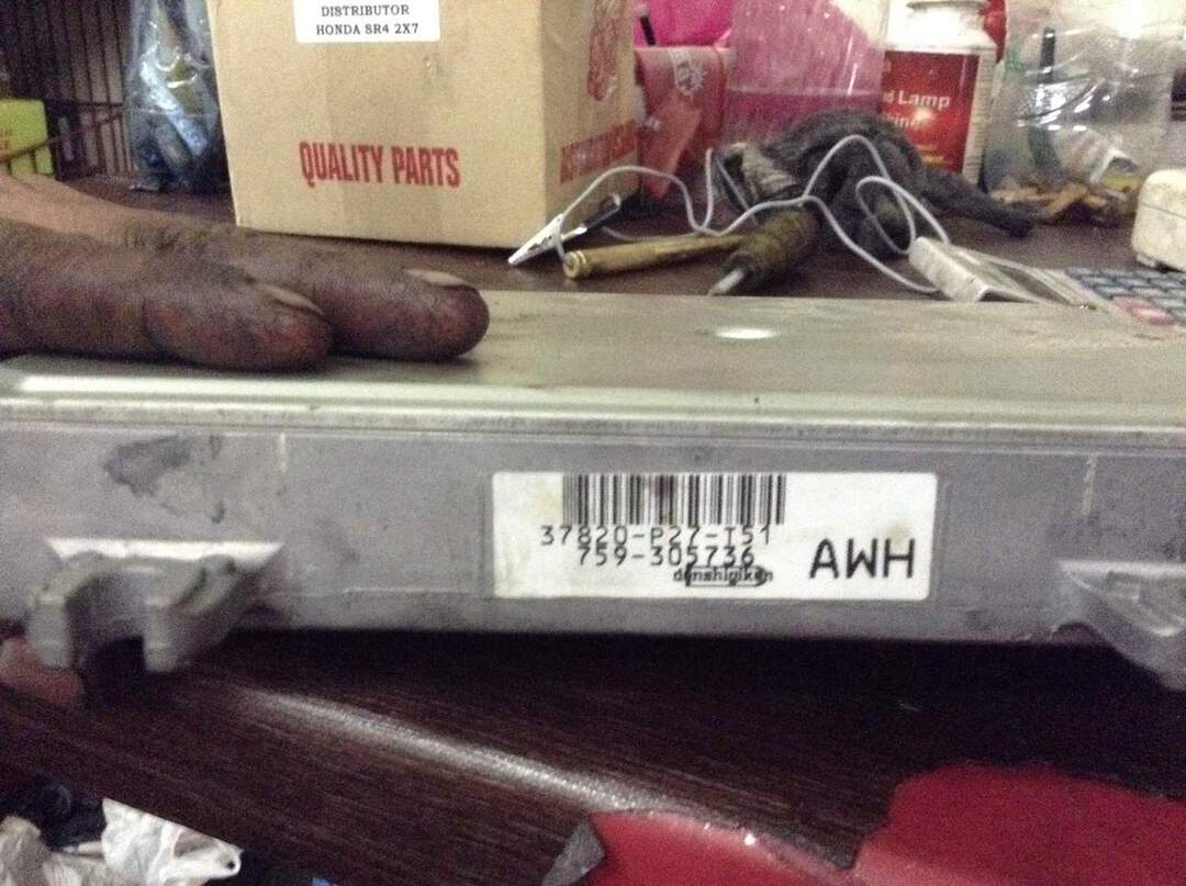

I oso having a problem right nw with my ecu.1stly it was happen when i turn on the key to ignition,found out my check light didn't turn off as usually.Try to start the engine,but no respond.I suspect my distributor is 'kong' b'coz that symptoms happen b4 last 4 years,so call up my mechanic wit a recon distributor.Fixed,but check light still ON & engine still cant start.Check ignition & fuel pump,everything is ok until my mechanic open up my ecu & found out some of the caps was burnt.
Looking around like hell,finally found 1 ecu code P29 (mine is P27-T51)The seller told me it can be use except no vtec function.Fix bck to my car and test,ok but after running on the road for 15 minute,suddenly check engine light pop up and few minute later engine stopped.Start back,ok for a while but now it becoming a continious problem on and off.
Back to the seller (halfcut conversion w/shop),he recheck the ecu unit by looping a wire and drive to the diagnose socket under the dashboard but the ecu is ok.(try in the situation engine is running,put the loop wire in,the check light is pop up,remove bck the wire check engine light off)he told me thats the way to check malfunction or working ecu.
Base on his experience he told me that the recon distributor coil is not so good,the coil is 'Hot' so it cut off the ignitions,he ask me to replace just the coil it self or find another used distributor.FYI my Idle Valve Controller unit also was not so good..was it also cause that too?
I m thinking to repair bck my actual ecu,and place it bck to my car(another RM)but would the prob solve?Was the coil in the recon distributors not good?Get another 2nd hand unit??Need some advise and sharing information from you about this.Currently i was driving on a zc single cam non vtec civic also,in a swap MT drivetrain.I swap the gearbox about 6 years ago,untill then this problem appears.
