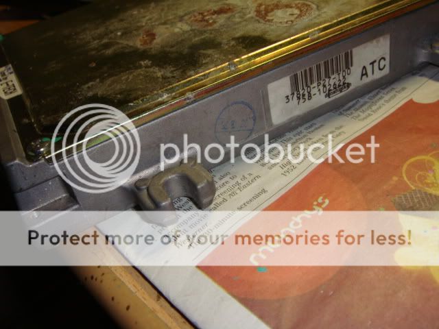

Dear Honda sifu-sifu sekalian,
I have a little question here hope someone can enlighten me.
Can SR4's ECU, 37820-P27-T00 be repace with 37820-P27-T01?
What kind of mod is necessary if i run T00 in T01's wiring?
You helping hand is very much appreciated!

Bro..
Normally for hondas, we only mention the center grp of digits...
In your case P27... so it should be the same spec...(except manual & auto).
Can be modified to prevent Check light for auto...
Any special reason to replace it???:biggrin:
For the below P27-T00 was for a manual transmission car...
Pls link if need repair....
http://www.zerotohundred.com/newforums/honda/315717-ecu-p27-civic-eg-1-6-sohc-repair-report.html

Bro...
Welcome.. and fyi... honda pin out are all the same.
In your case... you are having OBD1, so all obd1 have the same pinout...
e.g p27, p28. p08, p30 all can plug & play... differents are got vtec onot, knock board onot..
Just plug and play and if no CEL then 100% okay....
How bad is the T00 ecu? If you dun have any plans for it pls donate to me...
