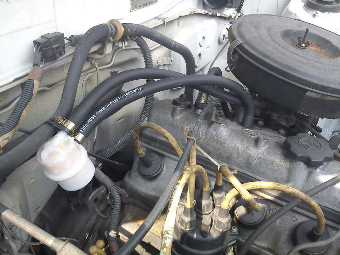

done my DIY oil catch tank..
on my AE101 & KE70..
pictures coming soon

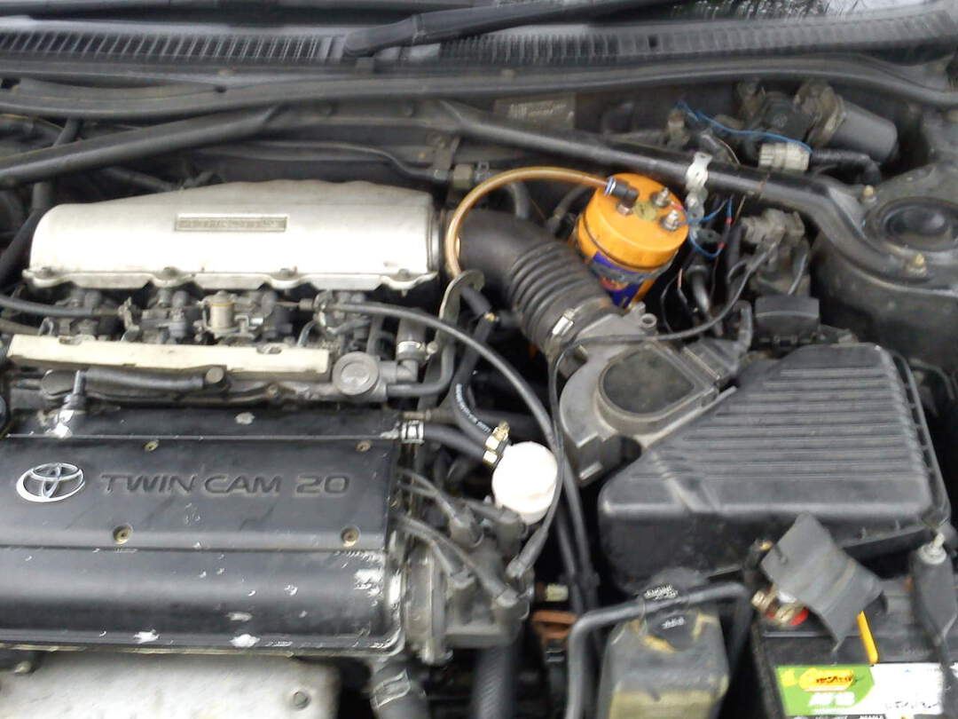

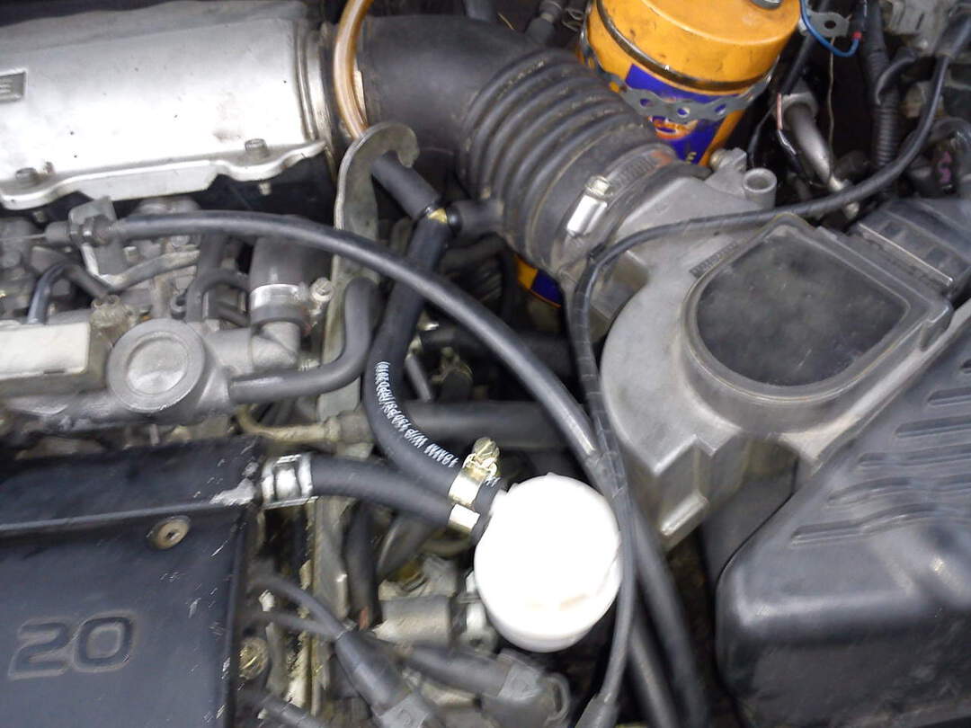

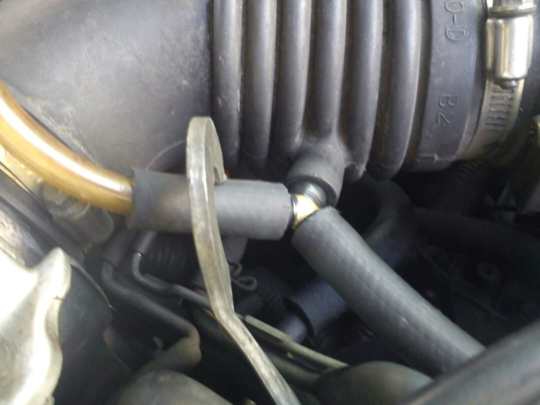

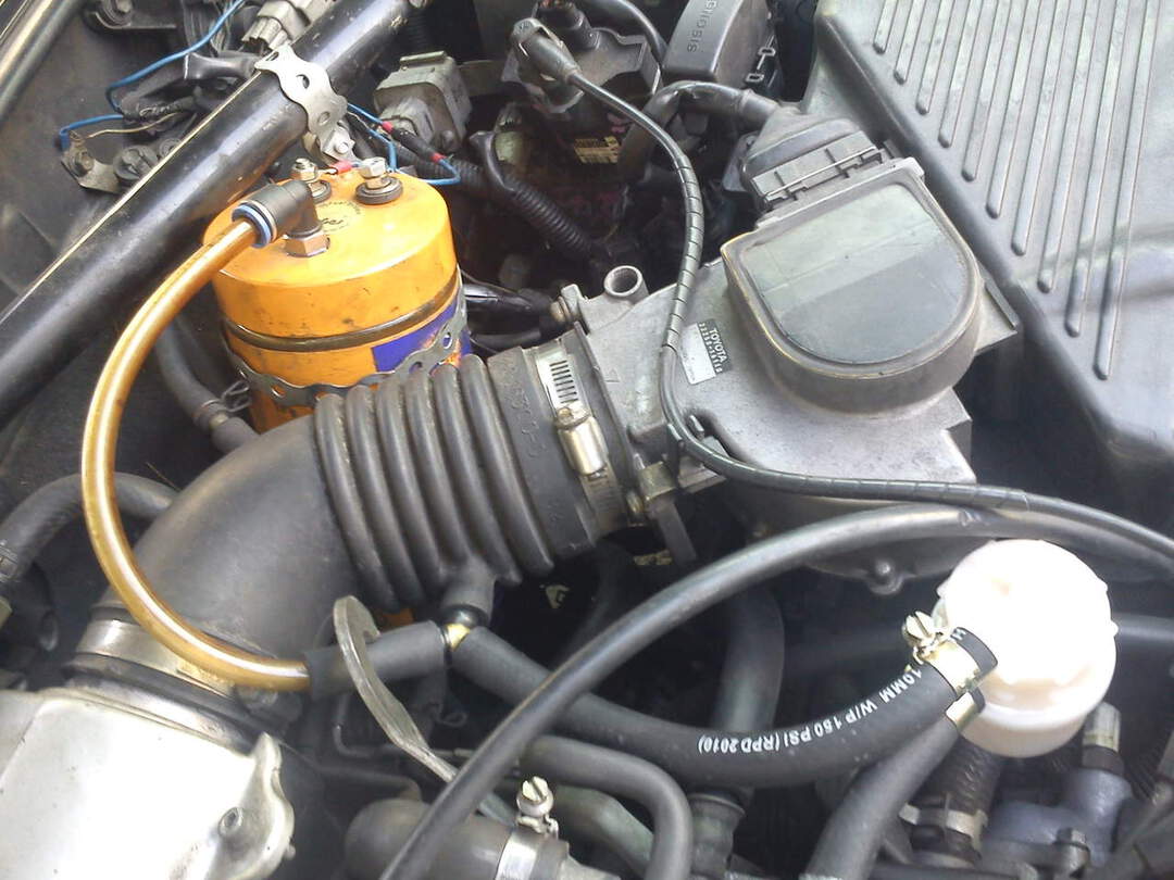

as promised..
pictures here!!!
hi bro zul,
can u tries to upload overall picture the hose connection from oil catch tank to engine head. because i also wanna to install this oil catch tank on my silvertop engine. :driver::biggrin:
hi bro zul,

hi bro zul,
i still quick not understand well regard this hose section i had draw in red colour.(please refer to attached photo. based on this pic, that hosing will be connect to where? :confused:
oh.. that's my hydrogen generator hose.. here's a few more picture
:biggrin:
