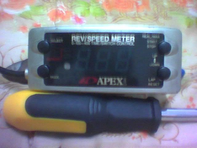

First.. you must have RSM la off course.. so this is mine..

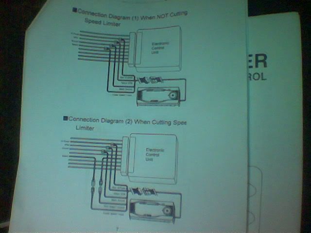

Then find the manual for the coloured wires..
EG-red> +12V.
-black> ground aka -0V
-orange > +12V
-purple> speed signal
-yellow> RPM signal

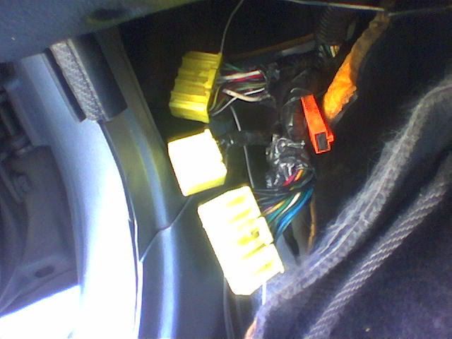

Locate your computer box

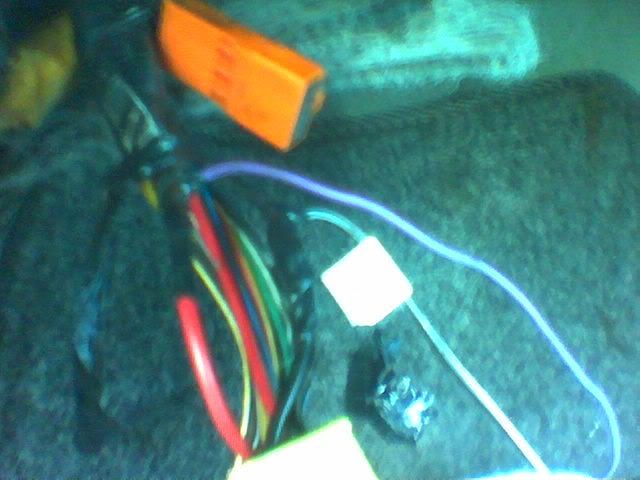

Tap the wire connection accordinglly..

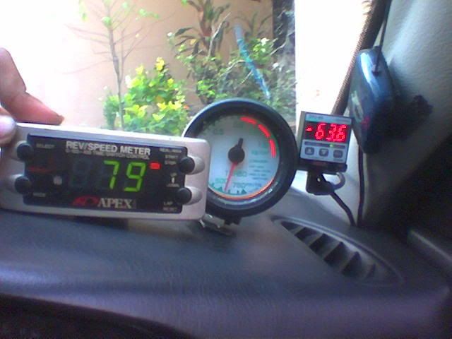

After testing that the unit is ok than put it at the rest of your gadjets or use your imigination la....
Then can vrom vrom... kapishhh
