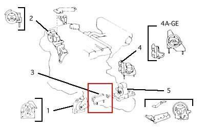

Hi, Did any of the AE92 owner install this centre mounting?? on the picture RED RECTANGLE. I already install and can feel the strengthen of the engine. Also can help to prevent others mounting easy crack. For model SEG above can install just drill the middle bridge two hole and screw on. I got order from Toyota Parts dealer and left two, RM190 per piece mounting.
Mounting can fit for all 4AGE 16V, 4AGZE 16v, 4AGE20v, 4AFE, 5AFE. engine
our ae92 centre bridge got original screw hole, just unplug the plastic cover on it. JUST Plug and play.........
