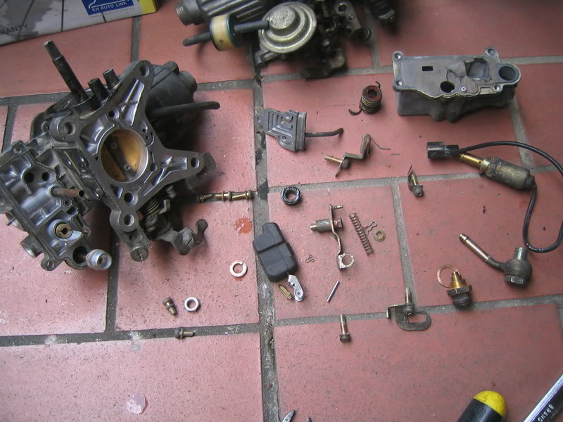

I have a question about purchasing a weber carb. I looked on a weber carb site but they did not have a kit for the 4g13 12 valve engine. I have a Lancer I am guessing its 1990~. Can I just buy a 32/36 dgv weber and then make my own gasket or adaptors? Or should I buy a kit that is close enough to my engine and then make the additional parts? Thanks in advance
On the weber site, they don't have any gasket or adaptor that fits this shape. Is there anywhere to find a template of it online?
