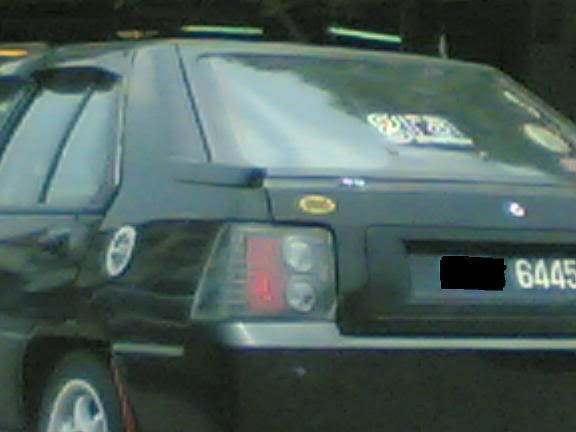

saw saga with big GRA sticker at the rear , sparco mud flaps, previously GT-wing took out (can see the metal round thing on the rear bumper where the GT-wing used to be) , racing Brother's fuel-cap sticker .. and riding with original LMST muffler.. :rofl:
dunno real GRA racer anot? hahahahaaha....

wakakakakkaa... GRA stickers also get cloned ady, now any car can feel like they are GRA racers lolzz...

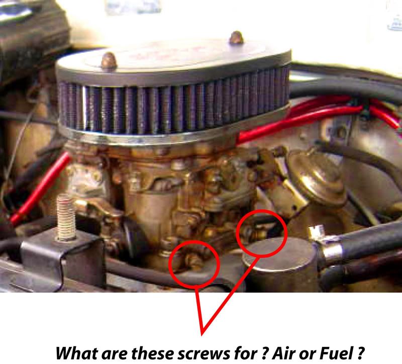

Can u give me a link of how diagram how to tune Weber DCNF 40 for me ? I need to retune my A/F asap.

daikor kend..... shoot some photo on ur dcnf (with da filter out) i try teach u via here, cos not free these few days.
I will upload a foto la.....Last time foto. Now camera not with me. There are a few screws outside I suspect is fuel or air wan.
Then the rest inside the throttle mechanism, u describe how should I tune n monitor lo.
Thanks....
Ok, then if I wanna tune down my AIR and FUEL down abit, how ?
Cuz I noticed my idling is 1100rpm, I loosen the idling screw (not even touching it) still idling at 1100rpm.
Which means my FUEL ratio is too rich liao, eat quite alot petrol compared to normal use.
So how do I tune down my A/F ? Is it the two screws I highlighted in the pic ?
Thanks
in every screw wen u turn in its closing it, standard weber manufacturers setting is turn out 2 full turns. from there u have to listen to it and smell ur exhaust.
smell whether got strong petrol bau o not... if yes.. means u r running too rich...
