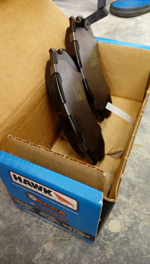

contacted Hawk brake pad seller, received it this morning. Install diy myself.
include grease too.

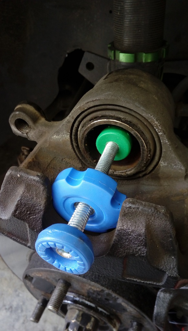

some diy clamp i got from baby lock gate, hahaha...

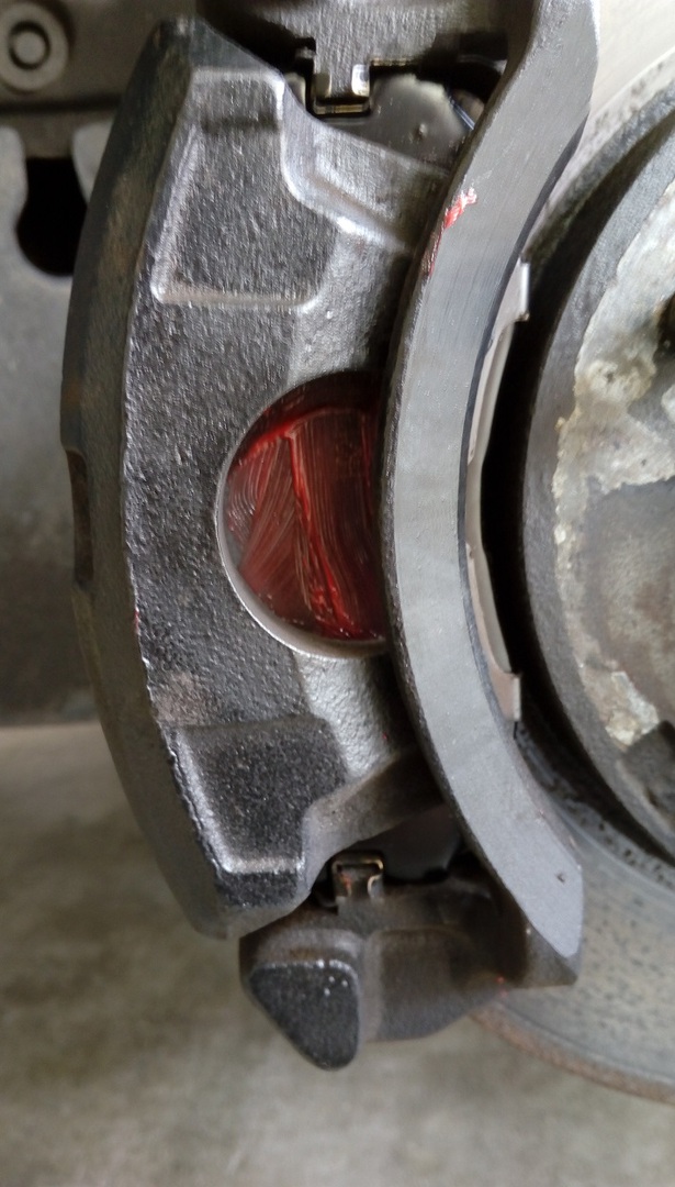

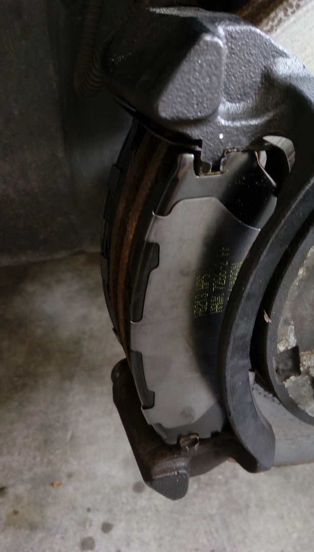

Got few bruise, caliper bolts damn tight.
give it a run at my taman for safety. At first feel like i got bomb, but after run-in. Yup it bite better than previous duno what brand. For rm150 is good.
Will give more feedback after couple days.

Nice piston pushback tool.
I just use a G clamp for wood work which is heavy.

That plastic tool can push the piston back in?
What Hawk Brake pad model?
Did you grease the floating pin?

Ya ya...grease which needed.
Not the working surface...hahahaha
Not all plastic, thread is metal. It work lehh..
