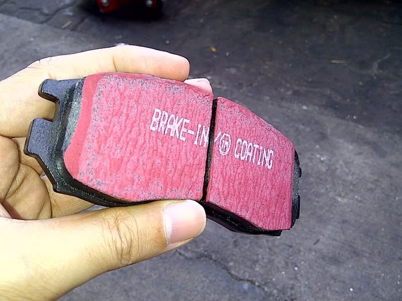

Does these brake pads are safe for use ?
Fyi,in the 2nd pic,the brake pad material melt like a wax ~
Thanks for any info ~
better change it, doesnt costs much though.
Too late,this car already crashed ~ when at genting downhill road,brakes suddenly doesn't work at all and crash the car in front ~
This brake pad i only replace about 2 weeks ago ~
With the old brake pad,1 week i go genting 5 times oso doesn't have this kind of problem ~ :banghead:

Yeah,the brake pad not deteriorate,but melt and the friction material i could just nick it off with my finger nails,even the Tokico brake pad i use before this wear til the backing already,im not experience with brake failure problem ~
tell u what,on normal highway,running at 120Km/h and suddenly wanna brake to 90-100Km/h there is a very stink smell,just like the brake pad overheat,i think it was still new so i didn't bother it but til at Genting mountain pass,on downhill suddenly losing all of the brake power i only realise it was the brake pad problem ~ sigh =S
But luckily in front of me got a car for me to crash to stop it from continuously gaining speed....if not me and my car will crash to the divider and if the divider broke will fall down the hill then sure Gone dy ~

Still doesn't know.....coz the mechanic refuse to tell me....when i ask he only say it was made in Germany but when i asked the brand he say forget la....bla...bla...bla ~
ive never seen brake pads melted sir, shudnt have driven it farther once uve spotted it melted like in the pix imo. braking system is the most important system in a vehicle fyi, if its not in good condition, then dont drive it

luckily its a minor accident...but still the damage have been done...in your case the root cause of the accident is pad (whether it is the pad it self or it was poor workmanship during installation to your vehicle)

brand saja german, made in china kut,,

So how can we find out what 'German' brand it is ?
We need to identify it .. so others can be aware or a report on that brand can be made !
I also doesn't know that it has already melt ~ if i know,do you think i would drive that at Downhill Genting,it would be like commit suicide ~
Til now i don't know the brand of the pad yet,wait til i take it out for replacement 1st and see wheather there is a brand,if there it is i will post it up on here ~
