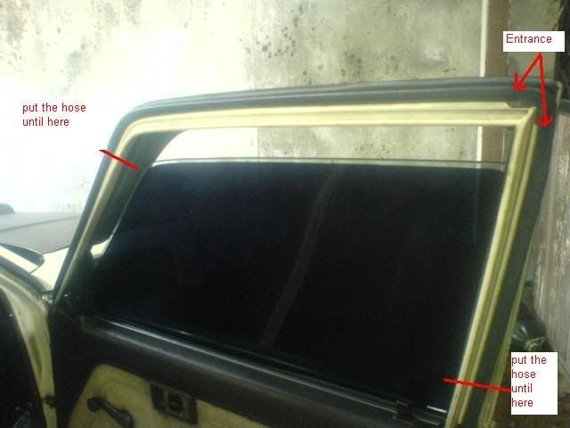

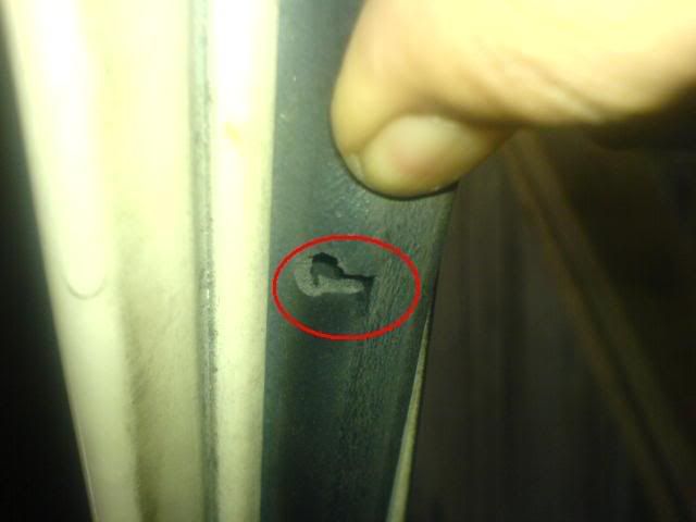

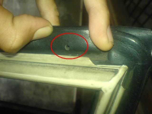

sowwi guys 2 keep u all waiting..... here some pic where to jolok the hose....
mzh82
Aug 28, 2005
100
6
KL
hehehe... oni driver's door i tint dat dark...saje...cannot tint all 4 coz no power windows..hehhee...got prob if get into roadblock. dat tint i have to cabut aniway...need to go to puspakom to endorsment...ekkeke
try to jolok dat much 1st, if u satisfied oledi, dat enuf. but if there still kelekang sound, mayb u need 2 put more... its up 2 u guys to put how much u want but carefull, my friend put too much, his door become hard 2 close
