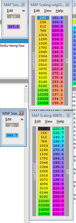

Airtrek you can use EVO's MAF,you just simply rescale the MAF via eculflash
Evo's the top,airtrek the bottom.
