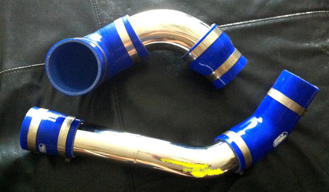

I know I have a large boost leak from what I believe is the pipe that runs over the rocker cover from the inter-cooler to the turbo, as someone has made a home made piece of pipe which sucks. Im really struggling to track down an aftermarket part or original pipe here in England.

A set of custom made inter cooler pipes with 2 sections (turbo to inter cooler & inter cooler to throttle body) is rm450 before postage. It's custom made. They're stainless steel and comes with 4 Samco connectors with clips. Sold quite a few sets here. If you want original rubber ones, I have a set lying in my store room which u can have it just for rm100 without postage.

Cheers for that I would be interested in the samco and stainless set. Any idea on cost of postage to the UK? id be happy to purchase them of of you.

My inter-cooler piping has been made up by a previous owner and it is terrible and leaks like crazy. So it has to be replaced eitherway.

Big thanks to stutzedward who has sorted my intercooler hoses which will be with me shortly :)

Right new inter cooler pips arrived before Christmas but I have only just fitted them tonight. Seems to boost up a lot quicker with no leaks which is nice.But still the car seems to struggle after 2nd gear and seems to surge and be lower on power than it should be.

bro, you can try looking for stock BOV from Evo 8/9. I think they hold the boost better than stock Airtreks. I am using SSQV, not much problem with boost other than unstable on high boost cos I am still using the original actuator. An external wastegate is advised if I want to boost high.
The intercooler piping helps a lot in terms of response. You will feel it even more during hot days where the rubber becomes spongy and expend pretty much during high boost.
