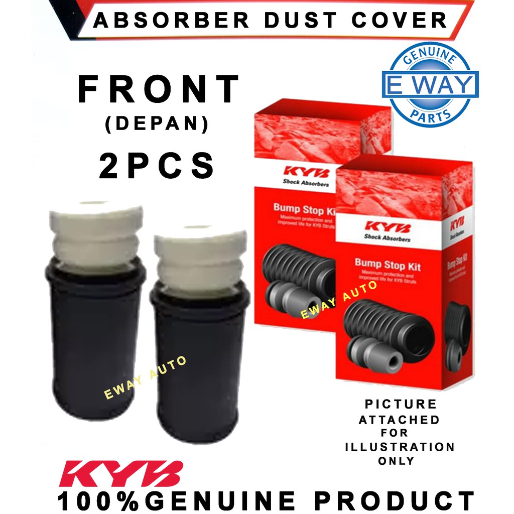

How many of you cover the shock absorber shaft with rubber boots like the americans. Supposedly shocks will last longer.
Stock have what. It covers the shaft, not covering the spring tho.

A lot of the older ones dont have, my old saga dont have this, I not familiar with newer cars so cant comment.

Should have. Yours probably disintegrated. My VR have, My ex wira have, even my 1996 Hyundai have. Is a dust cover for the shaft....
The covers are not bellow type, and they dont cover the whole shaft, some dirt can get under it, and scratch the shaft and damage the seals, thats why absorbers fail quite frequently over here.
I did. The boots prevent dirt directly splashes on the shaft. If the dirt manage to get into the seals and damage it or scratch the shaft too badly, your shocks will leak
The cover should cover the whole shaft when its on the ground. Cannot see it when its lifted, its not enclosed as well.
Yup, covers just slightly more than the exposed shaft. But after long time use, the cover will tear too.....
