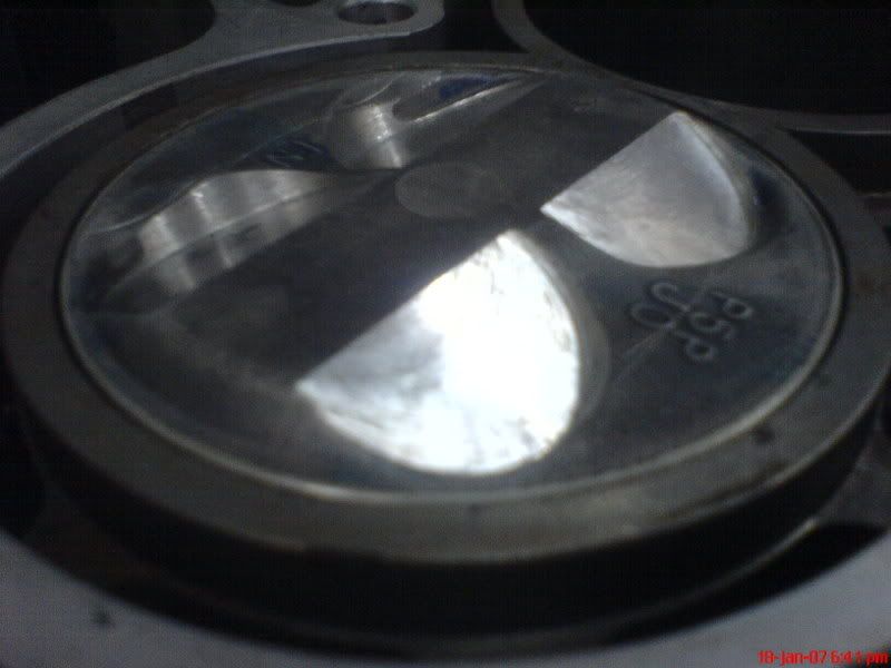

I already did shaving the valve guide long time ago,,,machine shop here can do this. Im talking about smoothering the chamber, not "korek" the chamber. From the piston you can see different type of brownish burnt,,,from there is the point of detonation (if you can read it). The chamber side that prone on knocking is the one that must be smotthen out.
These are the thing they didnt teach at engineering school:shades_smile:
Some of the engineering shop here can do things that overseas can do. You can angle the valve seal, backcutting and shaving the valve stick, Opening and deeping the chamber,,pumping the valve guide deeper for the most radical cams (so spring dont bind).
If you have a well burnt head/chamber,,,once you open the piston youll be suprise that there will be no deposits,,,not charcoal or whitish colur. The head itself will clean the chamber ,,.
Those are the black art that i learnt from my gurus,,,to be frank most 11sec machine do practice this,,,otherwise their machine wont do 11.
Actually I've seen this.. the picture I posted here a while back is actually an engine that's seen quite some mileage.. around 15-20K kms.
It's clean allright. :P
I'm sure you've heard of this engine.. its one of the earliest crazy builds.
