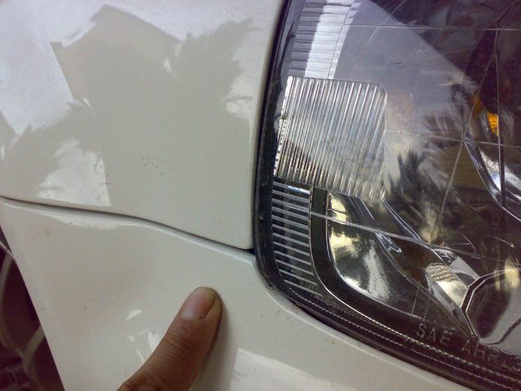

OK... This is my car's front pic.:biggrin:
Pic 1
-The headlamp and bumper is not flush... i.e. the headlight's is poking out
-The bumper and fender are not allign properly, funny cuz it seems tat the bumper will misalign itself after awhile.:stupid::stupid: Even though it's been screwed up properly.

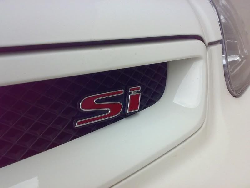

Pic 2
-Last time fender-bender on the driver side, so u can c tat there is a bigger gap between the grille and bumper ON the driver side....
Pic 3
-There's a gap between headlights and fender......
I hope this can clarify a little, thanks for ur info.....
Pic 1 is pointless coz all EK are fixed with the headlights slightly pop up from the bumper, about 5mm. Of course, if you don't like this raise 5mm you can make the headlights flushed with bumper by adjusting the headlights.
Pic 2 is not the grille having problem but in fact your bumper. Usually if you make sure the grille are nicely slot into the bumper, everything should be tight up with screws underneatlh. But if your bumper position is not right, then it will force the grille to pop out like what you have here. IF you check your driver bumper, you can see it's poping out. Why? Because your bumper support bracket is 96 and you probably didn't have the slot made properly, you can still move your bumper backwark a bit so the grille and bumper will minimized.
Pic 3 I don't see much gap between headlight and fender, but I see more gap between hood and headlights instead on both sides, I think you have raise your hood to high.
drewn123
Dec 13, 2005
220
1
1. Understood.....
2. Last weekend, while installing the FR bumper beam. I've screwed-up the grille and bumper. The bumper beam tat i bought, came wit bumper support bracket. I believe it's ek99 spec cuz the bumper beam is from yr99 and it's definately shorter than ej....:rolleyes:
3. Will check wit my mudguard-lao bout the hood...
Thanks a lot, appreciate ur help...

1. Understood.....
You definitely screw up the bumper position when you install bumper beam coz the bumper brackets below the headlights are adjustable which you can raise it up and down, or moving forward or backward. Defintely it wont fit right no matter 99-00 short brackets or 96-98 long brackets when you take it down, you have to adjust it back with numorous test fitting.
In fact, I'm not talking about the bumper brackets below the headlights, I am talking about the bumper brackets which is welded on radiator support, these 2 brackets are located on each side besides the grille. When you put 99-00 bumper on 96-98 chasis these brackets will block the 99-00 bumper to go in UNLESS you filed the bumper or you file the brackets properly.
What I can see is, your bumper looks pop out at the area between grille and headlights.

you just have to twist the rubber adjuster on radiator support to lower it down.

hikaru the master of .... err... u name it urself haha.
anyway, i do face the headlamp poped out by 5-6mm as well; which im not happy with. all ori parts except the headlamp. and same problem like drewn123, the fender will misalign with the bumper after a while. headache... fitment problem. i have to adjust it at least once in every 2-3weeks. :nurse:
Don't be a dickhead, people.
The headlights do pop out 5mm out of bumper. It's flushed with the hood and pop out 5mm at the bumper.
Just keep the 5mm rules on panel line then you are all set.

you have to make sure your bumper flushed with fender, so do u still need that bracket?

shawn, ur fitment is so neat until ants also can go throught the gap in between lol.
from the pic, ur headlamp looks like popping out by 3.5mm only nia.
btw, does the bracket help? i think i need that bracket too as i have the same problem.
nice finger u have there bro...lol
I just measured it, it's 5mm jack.
