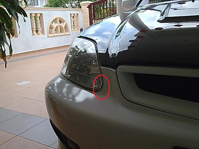

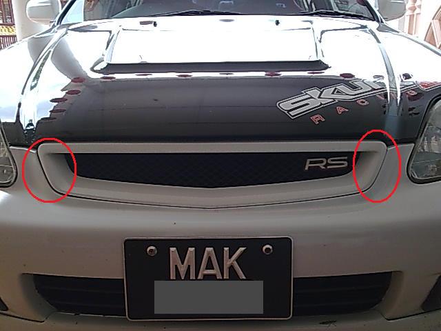

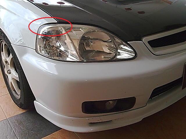

That's very difficult to say if you have front end collision before. You can have the gap minimized pretty easy without swapping the radiator panel.
After all, I dun know how serious was your accident and what's the impact on current set up. I will replace a new radiator support if the existing one is deformed.
but what the hack, I don't think it cost a lot for an used radiator support so just replace it.
I think it's about rm100~150 but if you wanna buy it new then it's gonna cost an arm or a leg.
Do you have picture of your current car? I really dunno how serious is serious.
I was very particular on these fitment as well the more I look at JDM EK. From my understanding our local EJ has different fitment standard than those in Japan. When I went to US, I can see the fitment standard is kinda different as well.
Usually EJ hood is sitting a bit too forward and the gap is slightly larger between grille and hood.
The US and Japan EK has the hood sits slightly backward which is flusehd from hood to grille if you view it from the side.
It wasn't easy for me to achieve this even I brought my car to professional panel shop coz they didn't waste much time on my ride. I went back and adjust them back myself. Put them on, take it down and do adjustment, put them back, take them off, do adjustment.... etc.

OK... This is my car's front pic.:biggrin:
Pic 1
-The headlamp and bumper is not flush... i.e. the headlight's is poking out
-The bumper and fender are not allign properly, funny cuz it seems tat the bumper will misalign itself after awhile.:stupid::stupid: Even though it's been screwed up properly.
Pic 2
-Last time fender-bender on the driver side, so u can c tat there is a bigger gap between the grille and bumper ON the driver side....
Pic 3
-There's a gap between headlights and fender......
