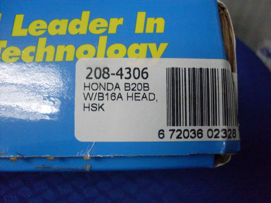

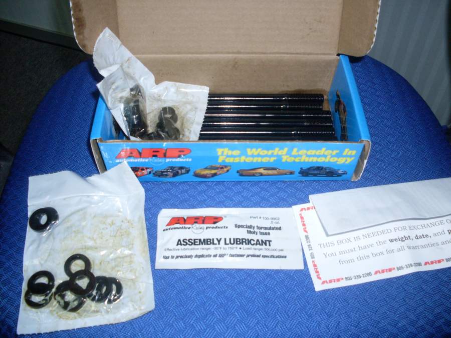

-ARP head stud (must haveeeeeeeee)(just bought)

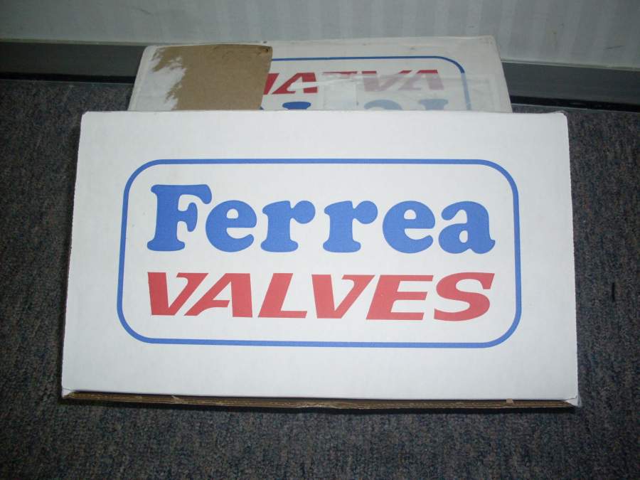

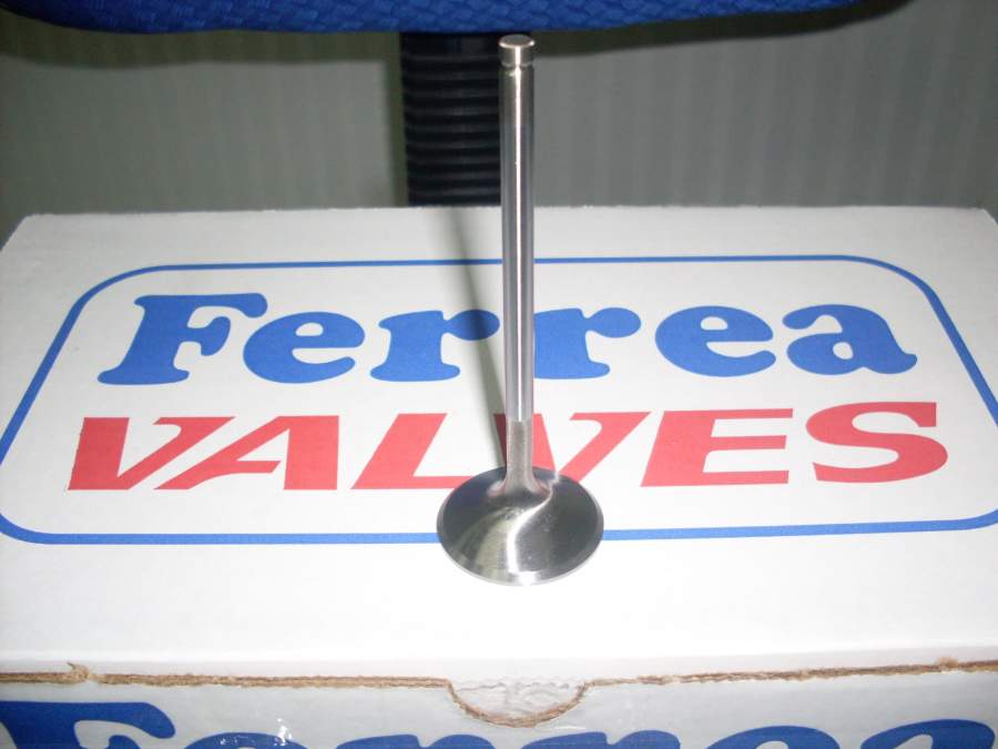

-Ferrea Valve ( for my budget only 6000 series oversize 1mm)(just bought)
