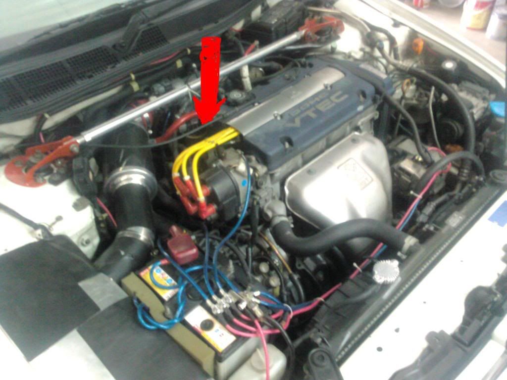

bro ...........what is EGR....where is located???? isit the sensor on the exhaust piping under the engine??? :hmmmm::hmmmm::hmmmm:
that at the exhaust piping is the oxygen sensor,... o2 sensor,...
the EGR = exhaust gas recirculation
is located next to ur valve cover,... left hand top corner,... looks like a cup
sorry bro cant get where isit..............any pic that can help ..pls thanks
this is from accord enginebay,... not 100% sure whther the EG enginebay is like that or not,.. eventho i used to own an EG,...
