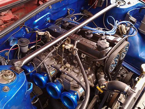

Ok enough talk, here's the real deal. I have acquired a Redtop NON TVIS 16V 7 Rib bottom end and matched it with an AE86 Bluetop head. The head has been completely reworked with a stage 2 P&P. Equipped with the following gears:
- Mikuni (SOLEX) PHH44 Twin Side draughts
- URS 4A-GE Manifold
- URS "Donuts" short Velocity Stacks
- HKS 256/7.9mm Intake and Exhaust Cams
- Metal Head Gasket
- Mallory CDI Hyfire 6EZ + Mallory Promaster e-Coils
- 4Ke Custom Distributors
- Ultra Silicone Plug Wires + NGK BKR6EVX Plugs
* and many more.....

FC is so-so with the current jetting. Depends on Jets used, FC can be easily controlled.
Power wise dunno yet as will only dyno after change clutch and pressure plate. Now lots of slippage due to worn used clutch.

Nice...here is my 2 cents
solex 44 too big for 256 cams...should run 288 or 304 cams with solex 44.
Q: where you want your power band?256cams perhaps run with solex 40.The 44 with 288 or 304 cams could take u between 5k-10k rpm(with the proper jetting)
you will probably need a electric fuel pump and regulator(i ran 2 of each)
cam tuning for 256 nor so critical but for higher cams u need a dial gauge
idling sounds rough from vid about 1500.I had(many years ago) idling at 800 (with weber45's and 304 hi-lift cams)
Not sure about your distributor and coils...coil can use back toyota slightly later version...say 3S
If u intend to run higher RPM later on maybe up your NGK heat range to 7 or 8

1JZTezza, this Starlet will serve three distinct purposes. When I received the whole URS/Mikuni assembly - it was indeed jetted with 200 Air Jet/150 Main Jet/57.5 Pilot Jet which were meant for cams with 272-288/9mm lift. For daily road use, I am acquiring 120-130 Main Jets to go with the 256/7.9mm cams. But in battle mode, I will swap in a 288/9mm cams which is intended to give powerband within 6000-9000RPM. - This setup is for SIC Track Days and Sprint Events. For AutoX the setup will be similar to Road setup.
I am quite happy with my ignition system now as it fares very well with the somewhat rich AFR. Using stock Toyota coils will have tendency to bog the revs.
And yes the fuel pump has been upgraded as well, using Mitsubishi Electronic carb pump which is quite fast is float spool (stops when it is full). Since using it no more shortage of fuel supply :)
My kambeng is still in the process of tuning and I would expect to do it still on regular basis to suit different needs :)
