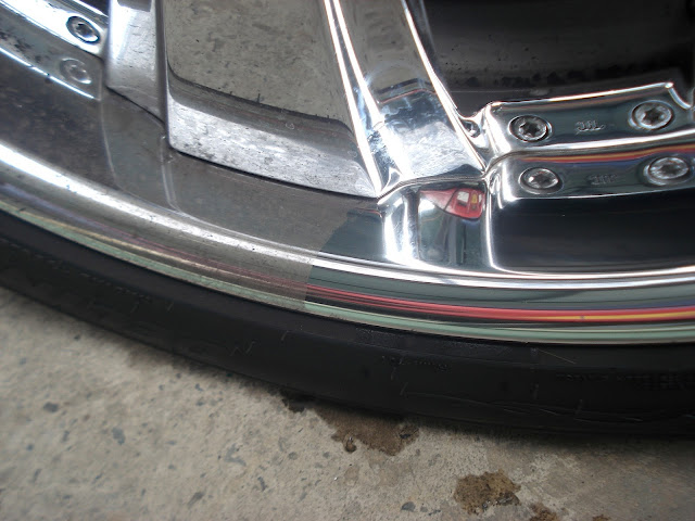

Starting from the wheels. The chrome was masked by the dirt. Front wheels have plenty of brake dust.
A 50/50 shot before and after. Wheels were cleaned by Optimum Power Clean

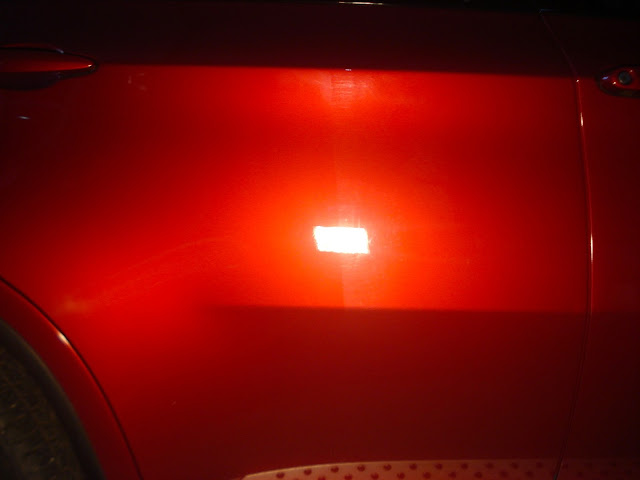

As for the paint correction, a 50/50 shot shows the effectiveness of swirl reduction and colour restoration. Note the deeper, richer colour on the left. the paint was compounded with Optimum Hyper Compound on wool pad followed by Optimum Hyper Polish on finishing pad.
A close up 50/50 shot

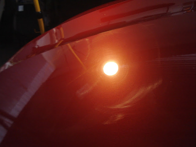

Plenty of swirls on the bonnet

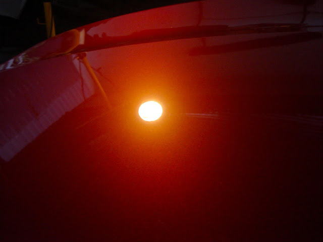

After correction.

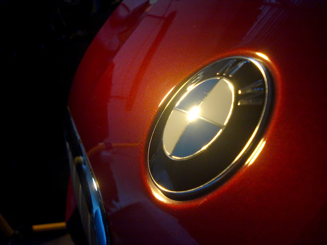

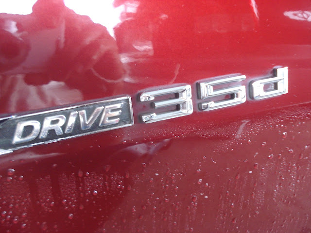

The car was waxed with Autoglym High Definition Wax for a HD finish.
Rich gloss. Worthy to bear the propeller badge...
