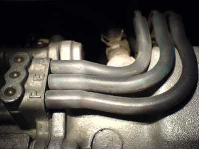

also, the 4g9x throttle bodies have 3 nipples at the top of the TB that has the letters 'P', 'E' and 'A' embossed. currently have 3 hoses plugged into 2 solenoids (i think) for the 'P' and 'A' and the 'E' is to the EGR valve (Exhaust Gas Recirculation). i know the GSR intake manifold doesn't require the 'E' to be connected but what about the other 2 which are connected to the solenoid?

here's the pics.
these are the P, E and A connections. (i'm guessing Pressure, Exhaust(EGR) and Air(/fuel?))

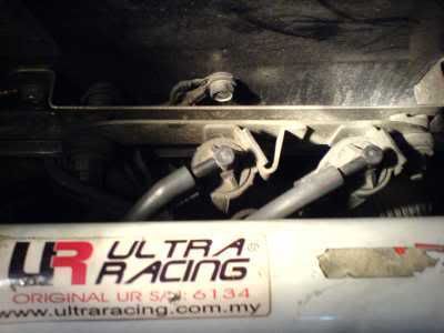

the 2 solenoids (i think they are solenoids) connected to the P and A hoses.

hmm... i do notice the P,E,A nipples at the tb... but mine 4g93t gsr oni use the P oni... the E and A is not connected.. hmmm i wonder y...
any1 knows the reason??
and i'll check mine if the "solenoid" are connected to sumwhere...

i doubt you'll have 2 solenoids. at most also just one. the intake manifold doesn't come fitted with an EGR valve so the 'E' nipple is definitely not plugged. same for the 4G91 engine.
